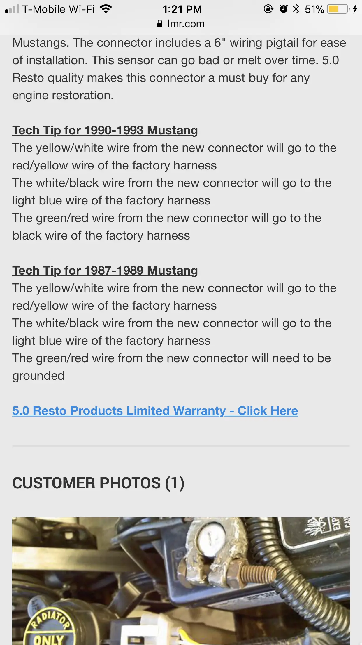

Do they interchange in terms of the wiring? Can I plug a 90-93 sensor into my '88 harness?

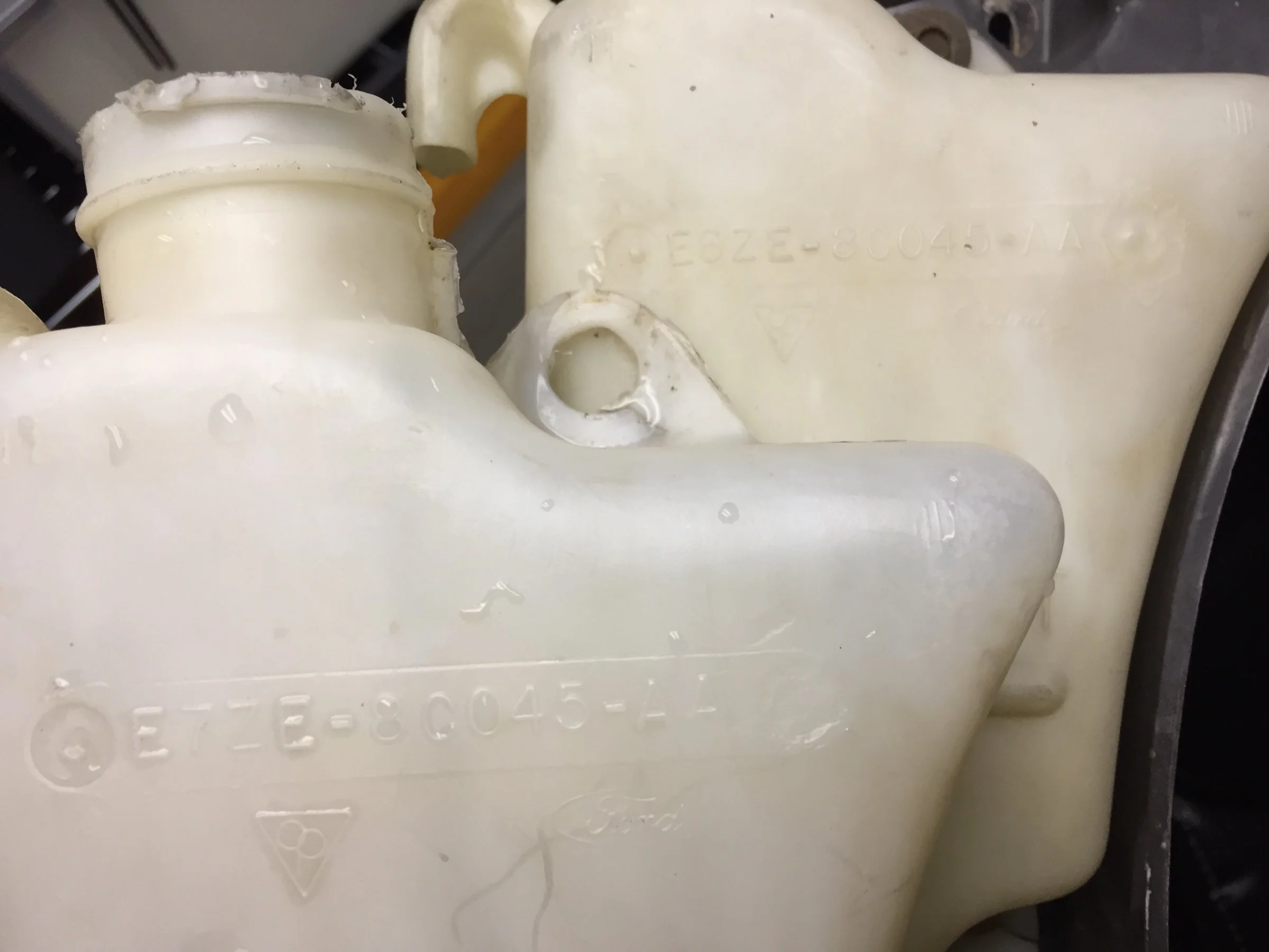

Background pic, my original 1988 tank without coolant sensor. Part number e6ze-8c045-aa. Makes sense as 1986 had same bottle and no sensor available
Foreground, a 90-93 tank with sensor part number e7ze-8c045-aa and 1987 was the first year a sensor was offerered
Other than the different features for the cap, same damn bottle . Internal features are the same. So maybe you can use the 87-89 sensor here.
