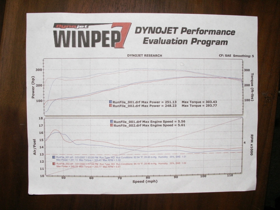

Combos in my sig. I tried different fuel pressures and timing and the best was with 15º base timing and 39psi. Im going to do a compression test next weekend. The only thing I can think of otherwise is the heads are too big for my combo and there just isn't enough velocity. What do you guys think. It kind of sucks that the only thing I gained was a cool sounding idle.
