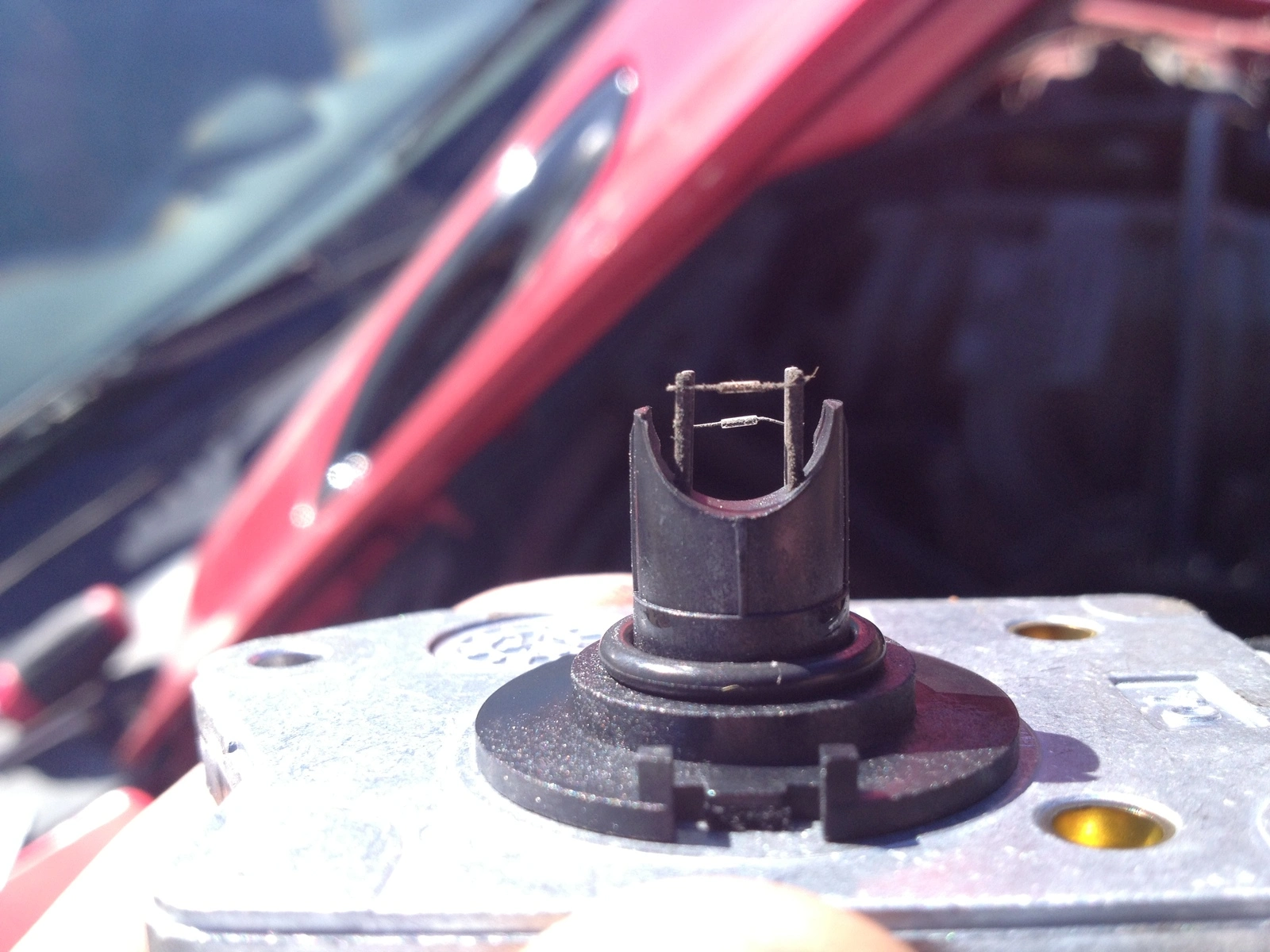

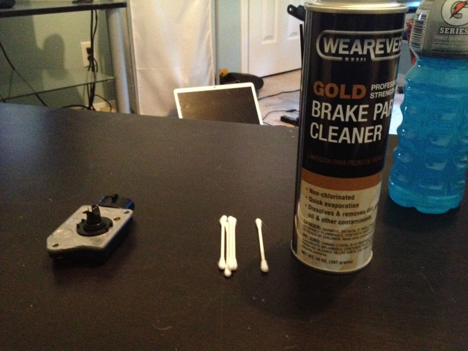

Today I cleaned the MAF sensor and it did nothing, I'm sure it'll be a huge difference once it runs properly though so I'm glad I did it anyways.
After cleaning it ran exactly the same, it wouldn't really idle, it would turn over, and the starter would keep making attempts and it would idle at about 300 to 400 RPMs for about a second and a half and die off again.
I did try running it with the ACT unplugged and then again with it plugged in, it made no difference either way.
Here are some pics of the cleaning though!
The Dirty Wires
And when I cleaned it off, cost me 10 dollars for the set of bits since they were tamper proof, and 5 for the brake cleaner which was buy 1 get one free. So now I have two cans of brake cleaner. lol

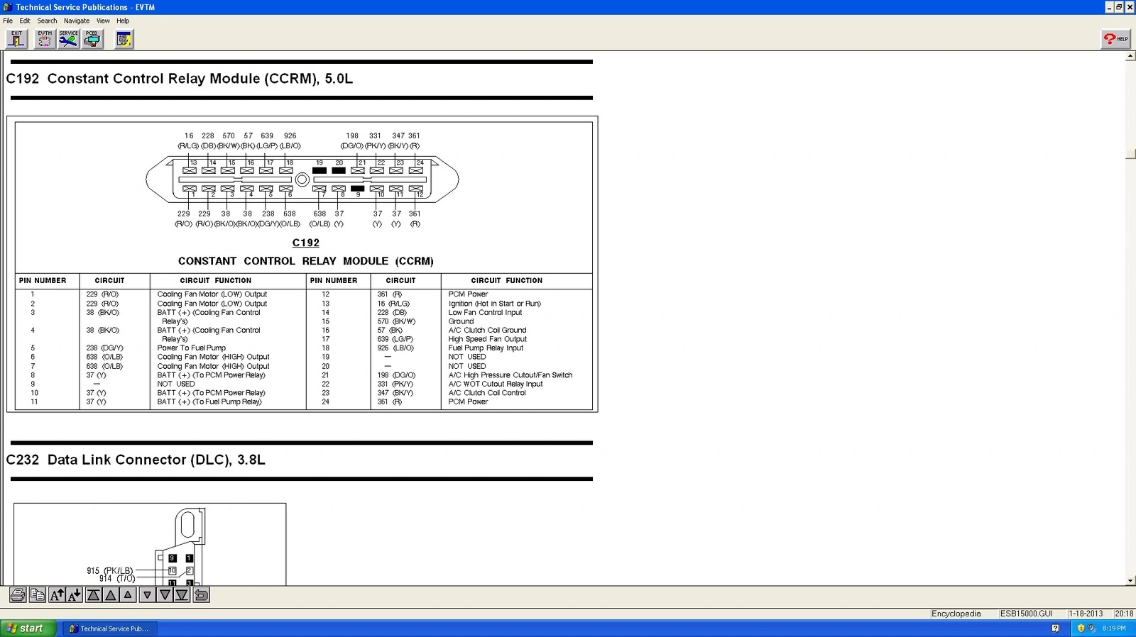

Also what is the pin #13 on the Ccrm for? I want to make sure it's unrelated and rule it out.
Should be accessory 12V.

See if this helps. Pin 13 is Ignition and is hot in start and run. I'm not so certain that the MAF sensor will withstand a blast of compressed air. It's a delicate part.

I was curious about pin #13 losing connection if it was related to the fuel pump relay. Wether or not the 12v was getting to it. But let's assume its good
