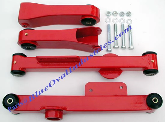

OK. I had the MAC control arm set on order, but i changed my mind, and decided to go another route. Luckily Spenc at 2KOOL Performance is restocking my order for FREE... i highly recommend 2kool to anybody in Ontario/Quebec!!!
Now, i have a choice of what lowers i want to go with.. What is the difference between the Pro3i and MM non adjustable lowers? Those are the two im seriously considering right now, unless you guys can suggest a set of arms that would be better for me?
I want my car to handle fairly well, but it won't be an autox car.
Thanks,
I think these are pretty good for $149.00.
Ya it's a great deal but they have hard urethane bushings on both ends of the lower control arms.. from what i have learned in the past week, they will force the suspension to bind under some aggressive cornering, and mangle my torque boxes because of this. Also causes poor handling characteristics like "snap oversteer" which i really don't care for, ha.
