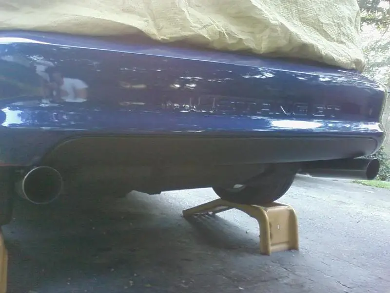

When my car was painted they painted the entire rear bumper. I really liked the look of the bottom part being that trim black color. I want that with black lettering. Would you try it yourself to sand the paint down and paint it black with trim paint? What would you do? Just trying to figure out whether or not to try it myself and if so then how.
Heres a really old pic of right after paint. is is lowered and taillight fixed since then.

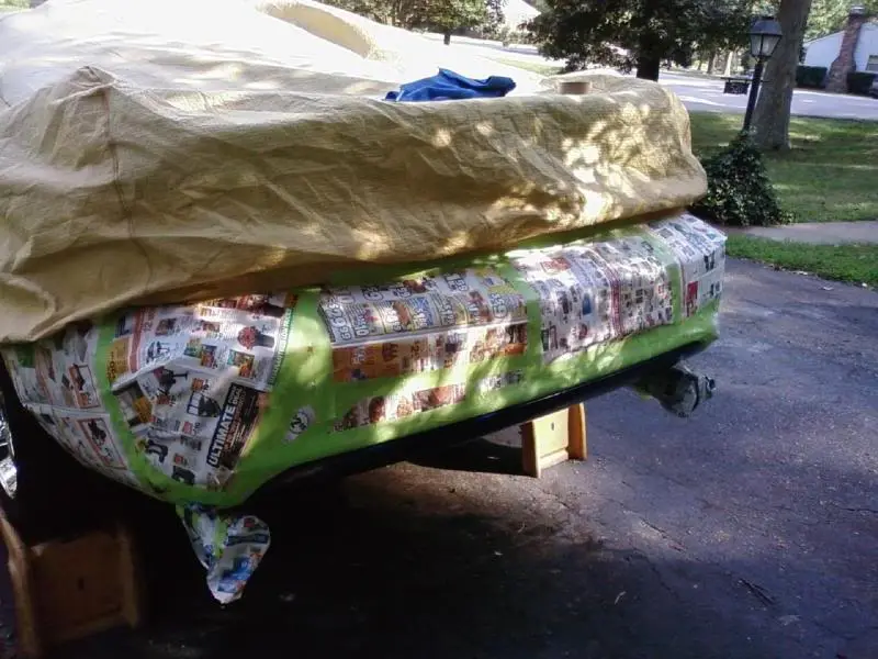

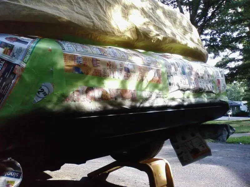

Well today I found the time to go and buy the bumper coating paint and a red scotch pad. It came out really well and am very pleased with it. Now time to order vinyl letter inserts. Sorry in advance for the crappy pics. Only had a cell phone on me.
taped off.
Painted
Done.

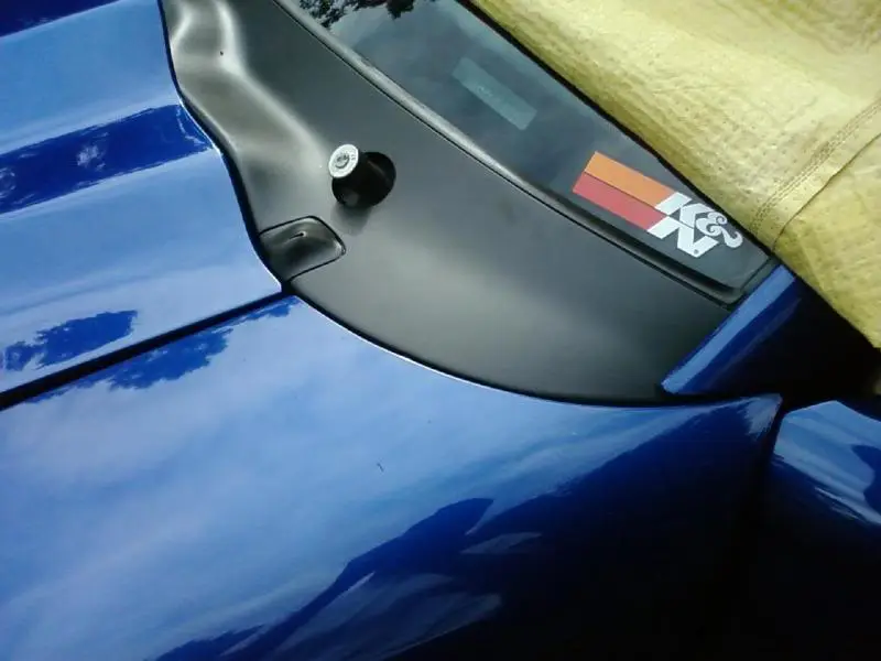

Also painted my cowl vent because it was faded and had dirt and crap in the screen
