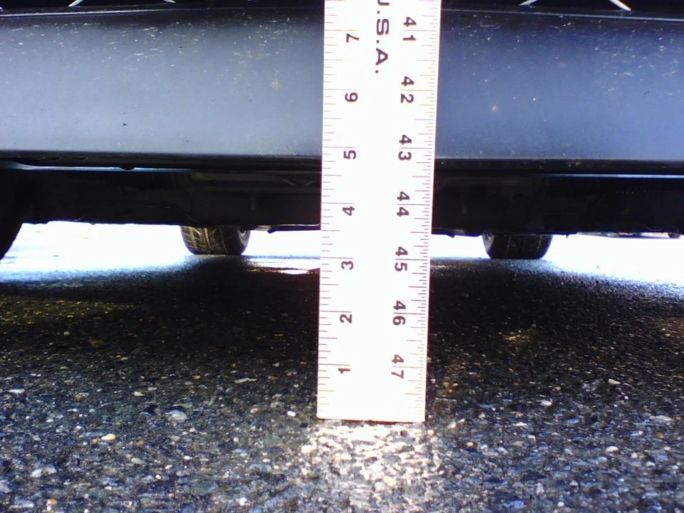

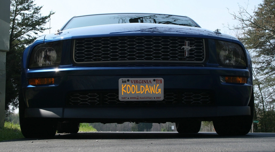

I have about 4 3/4" of front ground clearance being lowered 1.6" in the front, CDC Classic chin spoiler and 27" tire. I scrape quite a bit, but I'm going slowly when I do so it just pushes the spoiler up a bit. Standing at the front you can't see any damage, but run your hand under there and you will feel how rough it is:rlaugh: I avoid most entrances/exits from shopping centers that are steep(which isn't that many)and when I see something like that, I go diagonal whenever possible.

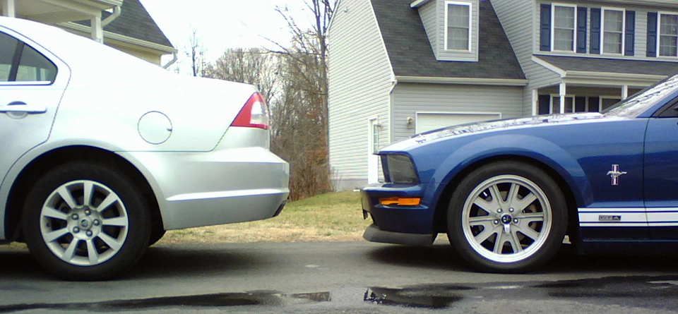

Parked behind a Mercury Milan
Most recent pic to show no visible spoiler damage
