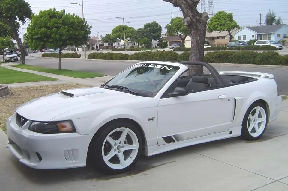

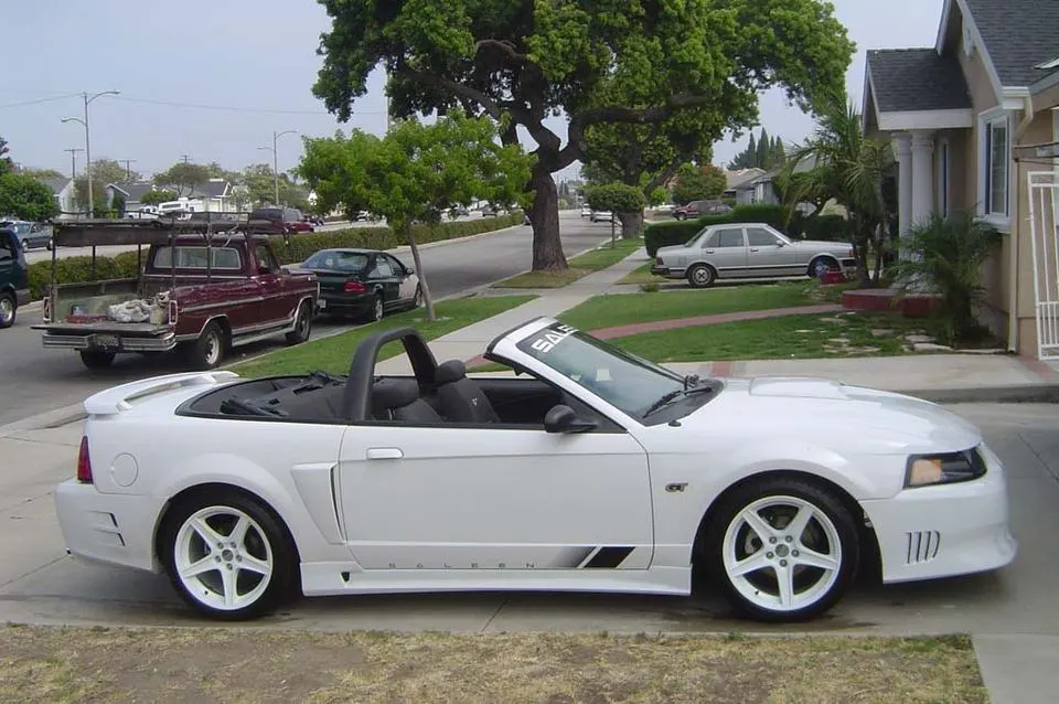

I have the H&R Super Sports as well which provide similar lowering to the Sportlines. You're going to need aftermarket struts/shocks to be this low, otherwise, you'll wear your stock ones out in no time, plus spend additional labor to insert the shocks/struts when you do decide to replace it. www.hrsprings.com H&R's website also recommends aftermarket shocks/struts with the Super Sport springs. I have Bilsteins which are great for ride quality because lowering your car by 2" will sacrifice a lot of the ride quality that you enjoy right now. Might as well get the best shocks/struts out there to maintain the best ride quality you can possibly get. Caster/camber plates are just about a must for cars lowered past 1.5". I've seen lots of people with alignment problems fast without caster/camber plates (for those who have been lowered past 1.5"). Pictures of my lowered convertible are below:
