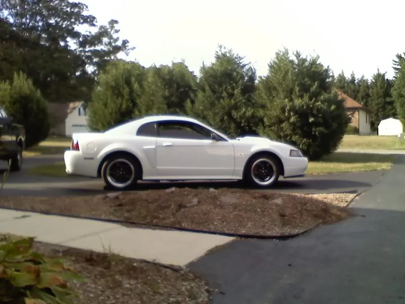

WELL!! all done. went smoothly, 3 hours. Have one little issue, my back on drives side sits a little higher then the right... im kinda anal so this bothers me lol but maybe they'll settle in place.
The front springs play a roll in how the rear sits. Depending on how the springs are clocked in the perch, it can influence the rear ride height.
If you clock the front springs clockwise, it rotates more spring into the a arm perch. This will lift the opposite corner rear slightly. If you clock counter clockwise, it will lower the opposite corner. This will also influence the front gaps a bit as well.

the springs will settle down though...when i first put my sportlines in the car still looked stock height....then over time it slammed itself into it really nice stance
