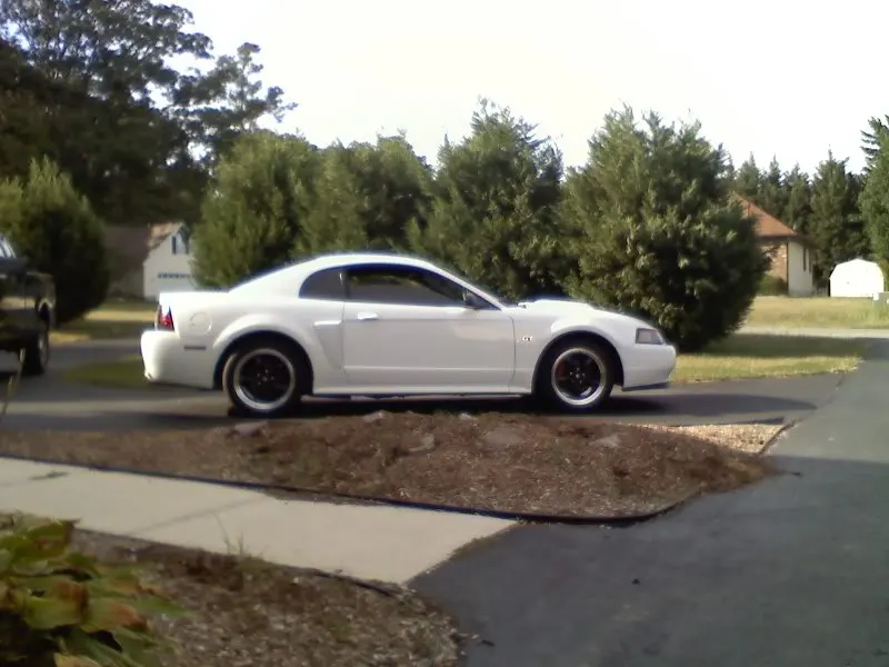

WELL!! all done. went smoothly, 3 hours. Have one little issue, my back on drives side sits a little higher then the right... im kinda anal so this bothers me lol but maybe they'll settle in place.
