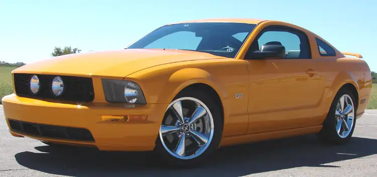

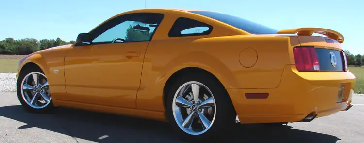

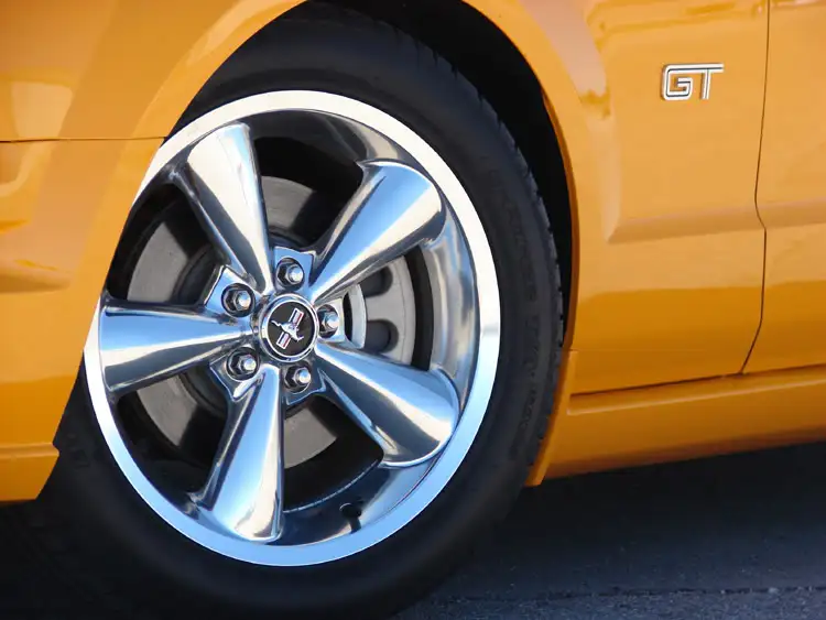

I have these springs... I didn't use Camber bolts, cause I've had **** for luck using these on Ford products. So, I just slotted the upper strut bolt hole where it mounts to the spindle, and can pull my camber where I need it and tighten it down. I also had to slot the strut tower to get the caster back in specs. I love the Ford Springs... it gives a great look without killing ride quality. I've had many compliments on how well it rides for being a lowered Mustang. Here's a pic:

Any closeup pics like this for the back tire? I'd love to get the K springs, but after seeing your car, it looks like it could be a very tight fit for my rear tire
