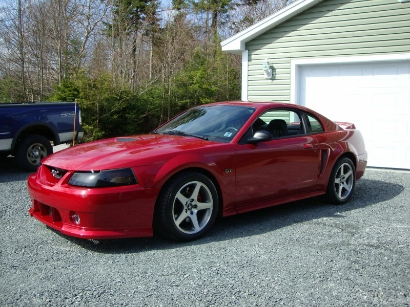

Hi Again. I mentioned previously that my setup is H&R progressive rate springs, Tokico HP's, Max. Motorsports Castor/Camber plates and didn't mention before that I replaced all isolators and bushings with polyurethane, to tighten up the ride. I've included a pic this time. The H&R's are very predictable when lowering the car, you get what the specs say you will get. If you choose progressive rate springs, the everyday ride is great, not rough. When you drive the car the way that it is meant to be driven, the springs tighten up and respond well, and yes the ride can be rough, but it is supposed to be. Tokicos like the other shocks and strut combos are made for lowered cars, if you use camber/castor plates. These are a good quality mid priced product for the daily driver and autocrossing. If you are going to race your car seriously, then look at bilsteins, but if you really need the performance, go to coilovers. It sounds that you just want to lower your car to make it look the way it should and not like the family sedan ride height that Ford, for some reason, feels that they have to produce. Most everything mentioned from all the contributors in this thread will get you where you want to be. It is just a question of how much you want to spend. You can get a good look and performance without breaking the bank. Let us know what you end up with and send pics.
