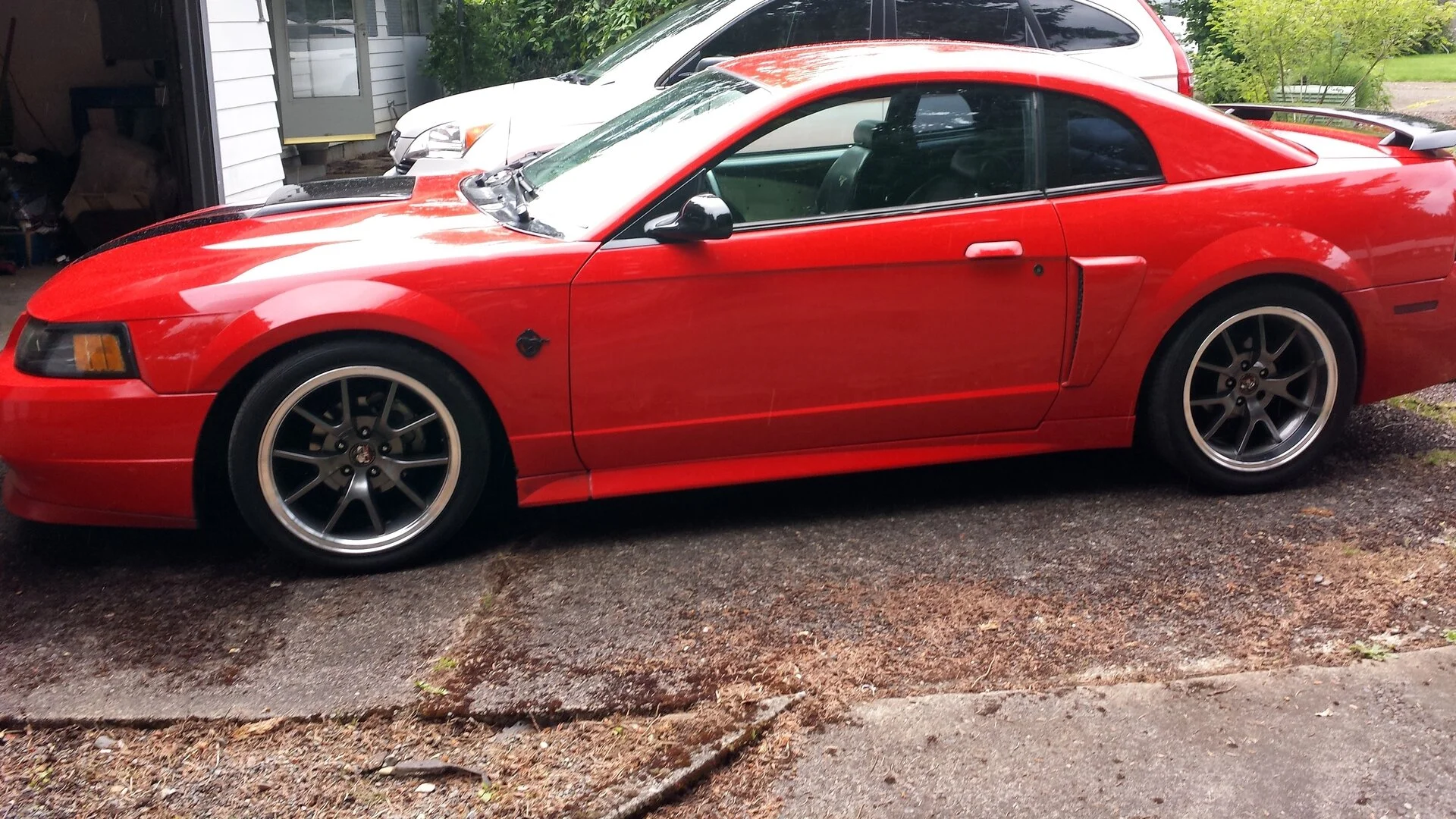

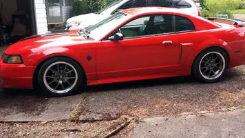

It really depends on personal prefence and taste. I have h&r springs without isos, Maximum Motorsports caster camber adjuster plates,Maximum Motorsports rear control arms,bump steer kit,subframe connectors and poly bushings. It is low but not a harsh ride at all.
