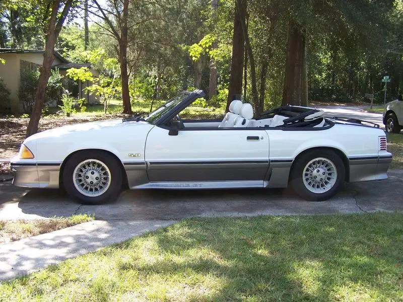

This is with FRPP B-springs with the isolators removed. Also MY_85_GT, you don't smell like gas everytime you drive the car with an offroad h-pipe. I though about one but I felt that with the top down I would smell exhaust fumes all the time.

Thanks for the picture and advice...What does removing the isolators do? does it effect the ride?...
