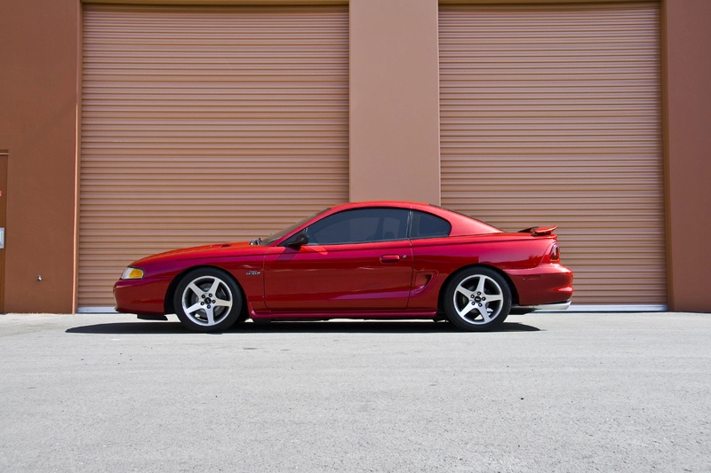

i ran Eibach Sportlines for a few years without any problems..... but then i went lower with no ISOs and all hell broke loose. Because i was so slammed my camber was so off that i wore out my tires in 25K miles.
Just installed MM C/C plates and now everything is perfect!!!
