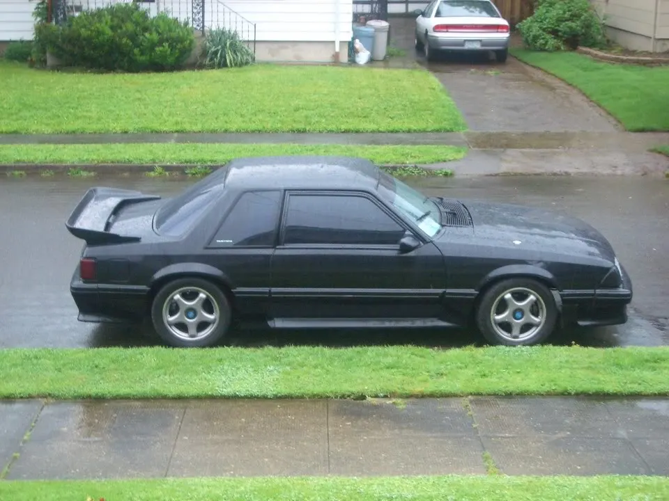

if you drive the car often id only go like 1.75'' max i got my car with a 3'' drop and i was crusing down the freeway thats under construction here went to change lans hit a pot hole and my 245's met my pass side fender and focked it all up you can kind of see it in that pic
theres a closer look at the damage
