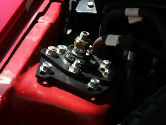

Steeda or Maximum Motorsport caster camber plates are
both good choices.Koni,Tokico,and Bilstien are all decent brands

What exactly CC plates are?Somebody please explain..........
They give you more adjustment of your caster and/or camber than stock.
My H&R SuperSports...

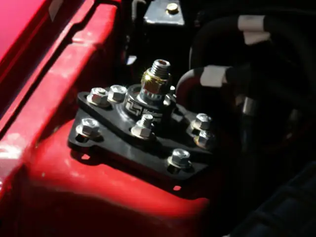

My Maximum Motorsports Caster/Camber plates...

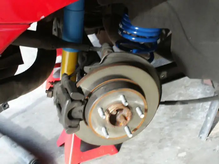

I also have Bilstein Struts and Shocks...

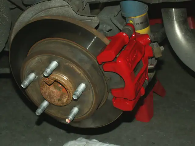

And I painted the ugly calipers...
