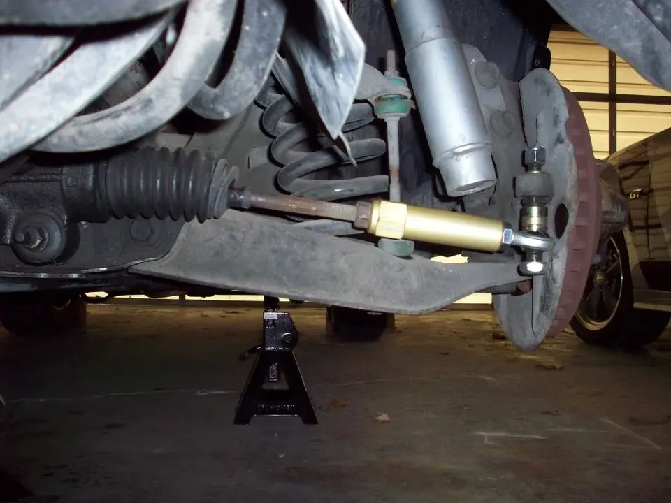

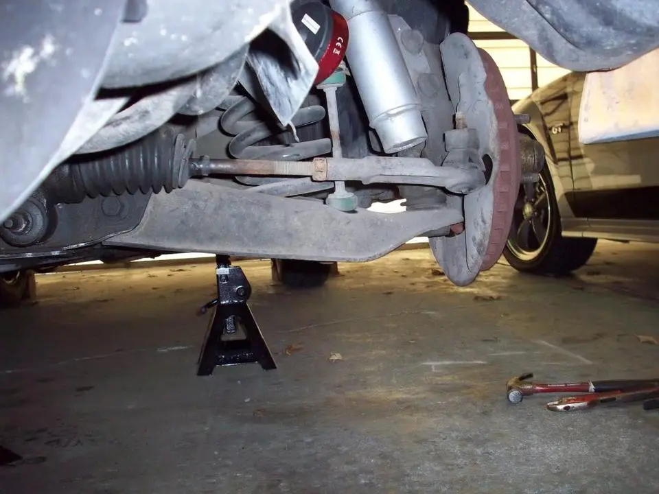

As with some of the other parts, a bump steer kit is not necessary, but it has its purpose. It can improve handling under certain circumstances. To give you an idea of what it does, I'll show you this shot of the bump steer kit on my '86. The idea is to get the tie rods on the steering rack close to parallel with the a-arms, so that as the suspension travels up and down, the tie rods and a-arms do not travel vastly different arcs which would unintentionally create a change in steering angle.
Before bump steer kit
After kit.
