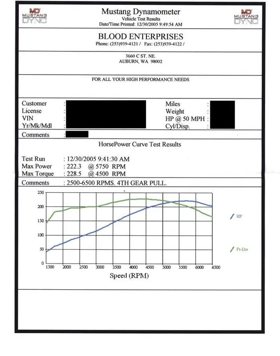

LOWEST PI mustang dyno numbers
Car : 1998 Mustang GT
Trans : T45 5 spd
Engine : 99 Windsor PI 4.6L w/ 19K miles
Mods : K&N FIPK, BBK Longtubes, BBK o/r X pipe, Mac Catback, 01 Cobra flywheel, 04 cobra clutch, Crower 68197 Cams, Comp Cams Valve Springs, Modular Depot 92Octane Xcal2 Tune, 4.10 gears
My old engine 120K miles, PI intake, O/R H pipe, Catback, 4.10's, and the K&N intake, made 205RWHP, 243RWTRQ.
This PI motor screams, but why the heck are the numbers so low???? :(

:eek: major low numbers, with my current (for now) NON PI motor with my bolt-ons listed in my sig, my car made 238hp and 268tq. That is with my aode trans too, I think my numbers are in the upper teer for non PI cars that still have the stcok heads and cams like mine does. your numbers are a mystery was this a regular dyno or a Mustang dyno? Mine was on a regular dyno and I have been told mustang dynos show much lower numbers than regular dynojets. Oh yea hopeing for another 60-80 at the wheels with the new motor, heads and cams listed as my NEW FOR DECEMBER stuff. :D

98 black magics car was probally run on a standard chassis dyno where the "low" car was run on a mustang dyno.. the mustang dyno will read lower because it's a different type of dyno.. the mustang dyno takes weight into account.. they make it harder too spin the dyne so the power output is lower.
Did you just go for straight dyno numbers or did they do a tune also? I got my Mach dynoed and tuned at Blood's. They installed a bung and adjusted the AFR and played with the spark advance also with my Predator. I was happy with the results. I figure on a Dynojet I'm pushing 300 at the rears with not much for mods. Oops, double post.
Wait, something isnt right. You didnt even gain 20RWHP. In reality, you should be dynoing VERY close to or at 270RWHP on that dyno...about like crzyhrse's mach.
Something isnt right, whats the A/F and stuff look like?
Oh yea....6700 is too high for your rev limit IMHO. Set it down to 6500(where mines at). When your approaching 6500, spun rod bearings become a problem. Keep an eye on your oil...low oil is what usually causes the bearings to spin, and these engines use alot of oil at RPMs like that.
