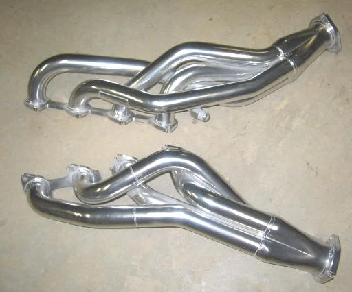

I've got a set of their mid-lengths on my Cougar. :D
I'm pretty sure they sell them in both configurations for Mustangs.

Yeah, but you missed my caption underneath, I am pretty sure they come in both configurations for Mustangs. Actually....they are custom headers, so I imagine they will make them any length you would like.

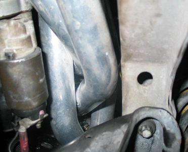

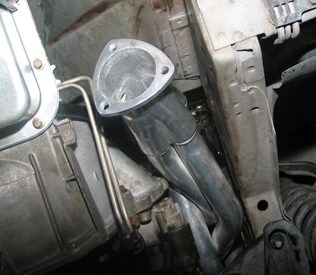

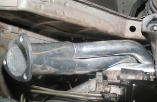

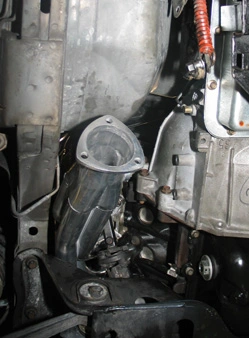

Well bill, as you can see, the Mid-length Kooks are a tight squeeze in the MN12, but they will fit.

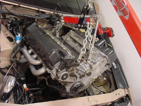

I installed mine along with the engine, much like the guy has done in this pic....
But a lot of people have opted to drop the K-memeber in order to install them from underneath. It does save a lot of hassel.
I wouldn't necessarily consider the MN12 a "superior chassis" all around. It's better balanced, but still a little springing. This is mainly due to its length though. It's true that the MN12 is a much tighter handling car than a Fox or a Fox4. Especially when you consider the major weight difference between the two cars, but for drag racing, it's pretty tough to beat the Fox's. There are a few custom tubular K-members available for them MN12's to lighten them up in the nose a bit. Mike Siska on tccoa has one and his car is set up strictly for drag racing and even with it's portly weight, he still managed a 10.5@130+mph.

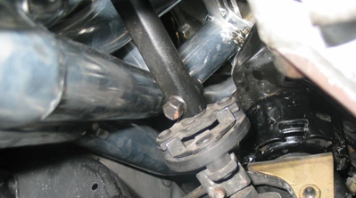

GB, did kooks include gaskets for where the headers bolt to the mid-pipe? I have this waiting for the "other" pieces and was curious about how two flat metal surfaces will create a seal (sarcasm).
Well, the gasket wasn't included, but I bought it with the headers at supercoupeperformance. It's basically a blow through proof copper "O" ring.
This is what came with my kit, but I'm sure you can buy the gasket separately....
