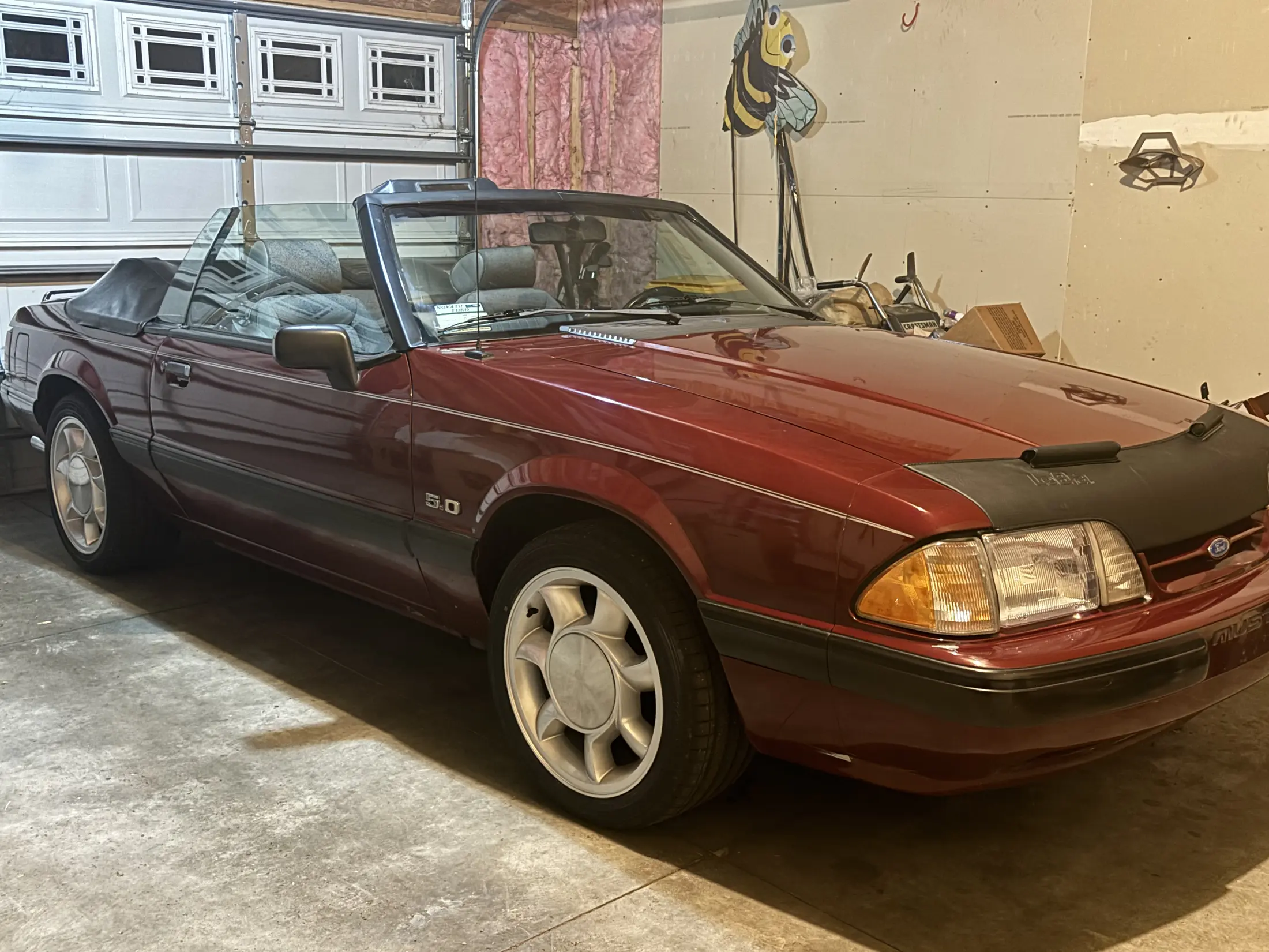

great forum have learned a lot over the years from lurking thru google searches figured its time to create an acct. 1989 lx convertible 5 speed here going through the checklist of 'gotta have/do' upgrades updates and modifications with a few personal touches. H/C/I is my next step and looking at an explorer intake, B cam and looking for advice on the heads.

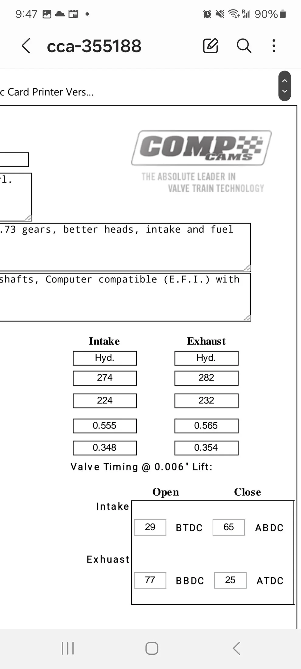

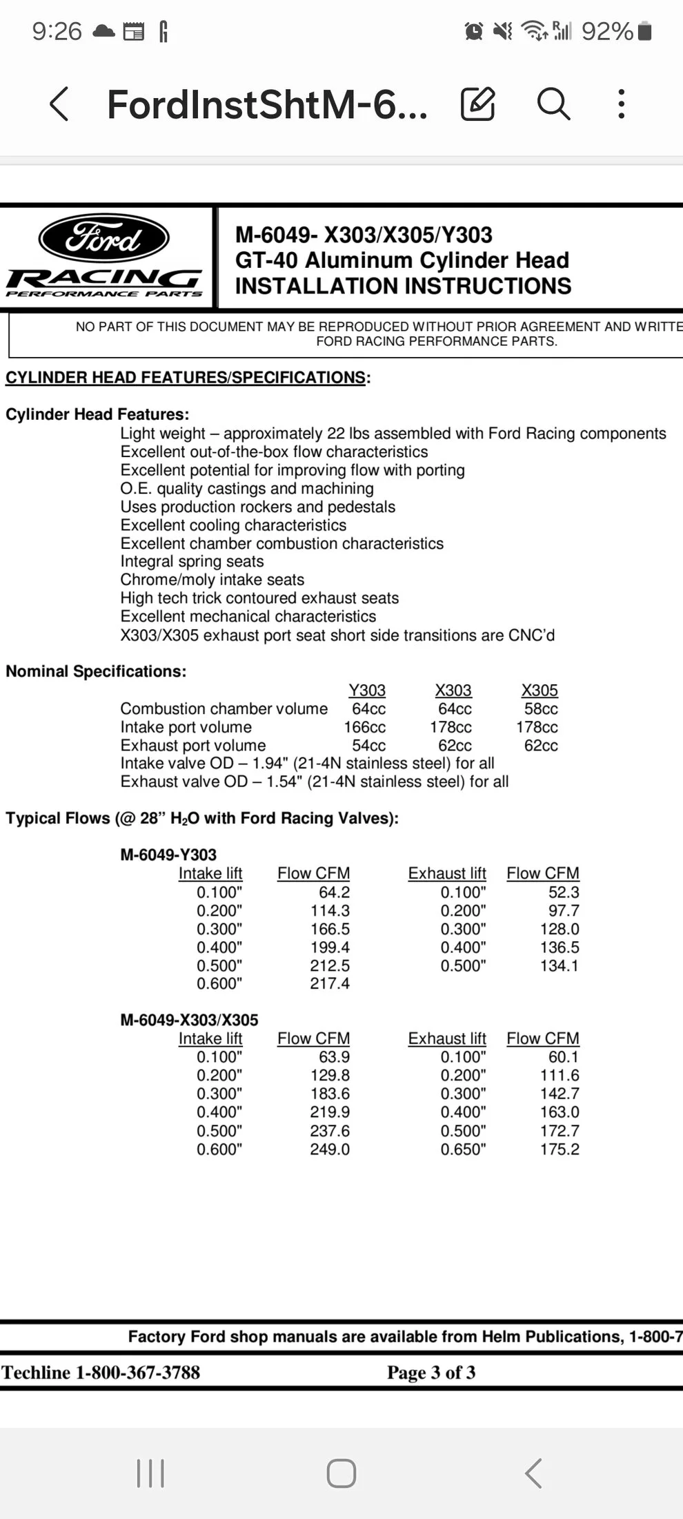

I've seen a rule of thumb that when you divide the exhaust flow by the intake flow, & then every percent less than 75% wants 1.5 degrees of exhaust duration @ .050".
Maybe this gives a decent idea of why split patterns work so well on GT40 style heads. Let's take the GT40X heads, for example. Skip to the second list, at the bottom, on this:
So, at .600, it'd be around 69.8%, which would need about 7.7 degrees. The XE274HR, a pretty good cam that would have manners similar to a B-cam is 224/232 @ .050". 8 degrees!
So voila! And on top of the right split, it has 1 degree more LSA, which I'll bet makes it even more street friendly than the B-cam. The extra lift should help a bit, too.
Now, most that are familiar with nitrous cams know that they generally have even more duration on the exhaust side, and that jibes with the idea that injecting nitrous is equivalent to having an even bigger intake CFM flow.
Just some food for thought for ya.
