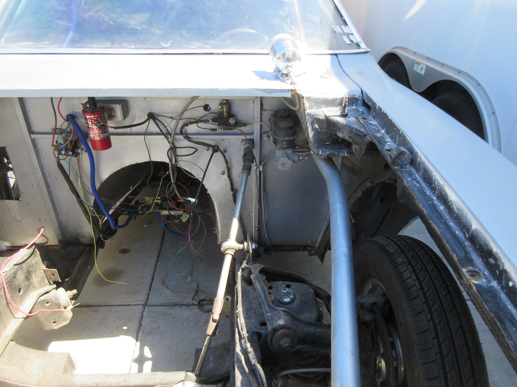

i will try to look for it,but fenders are bolted on.inner front fenders cut out!this is a pro street race car and not much of the original cr is there.

its a hot rod!no motor or trans,full tubbed with 9 inch and 14x32s.no dash or vin that i can find,was a drag car for years so thats what they did!

From that shot of the engine bay I'm gonna go out on a limb and say there's nothing anywhere. Unless Ford stamped the VIN somewhere else that I'm not aware of.... :shrug:

Yep, if it's where I'm thinking, it would've been on the rail that the fender mounts to. Since that rail is gone, so is the "flag" or whatever that I'm talking about.

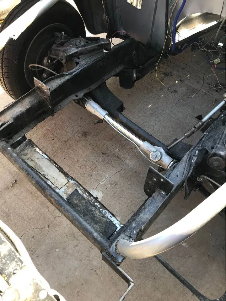

i think i can answer my own question!

Definitely a candidate for strut rod removal.
