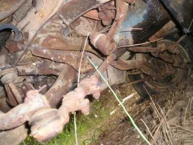

We probed and tested the car and could not find any areas were the rust had broken through except the battery tray. This picture shows the front suspension with rusted pieces. Mach1,suspen.webp I did not know that a 1970 Mach 1 could have front drum brakes.

Hey cool, the jack didn't go through the torq box! Now you really need to check the cowl. The car would obviously have to be completely gutted to avoid missing any hidden cancer issues. At that point you have a few options: acid dipping the whole chassis, bead blasting on a rotisserie, wire brushing by hand on a rotisserie. (this is all assuming the frame can withstand a rotisserie restoration).

drum brakes were standard equip on Machs, they are not part of some mythical drag racing kit. Disc brakes were otional on small block Machs, and I believe they were standard on big block cars. Standard equip on Machs in 1970 was a 351C 2 barrel, 3speed stick or FMX auto, 4 wheel drum brakes, and 9" rear (non-locking) with 28 spline axles and either 2.79 or 3.00 gears. Nothing special for standard equipment. Don't assume that just because its a Mach it has all kinds of special equipment. You need to fully decode the car to get an idea of its value, whxch the Marti report would handle. Don't make an offer until you find out what it is supposed to have, and also what parts are still intact.

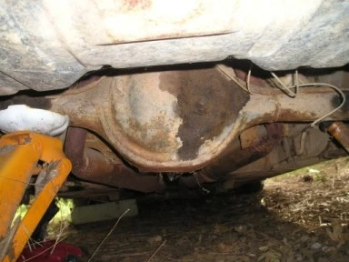

Thanks again for the replies. Not sure if I am up for taking the whole car apart for media blasting or acid dipping. I have added a couple of more picures. Mach 1,2 2(512 x 384) (384 x 288).webp . mach1,Floor.webp . Let me know if you think a complete disassemble is necessary.

First, I recommend full dissasembly. As said that car probably has a lot of areas that need attention, or you will just be band-aiding problems which will return in the future. If you're going to sink money into it, do it right.
Second, it's not a small project, and unless you are made of money, think 2-3 years, and a full garage to make sure you can take your time and dissassemble properly.
