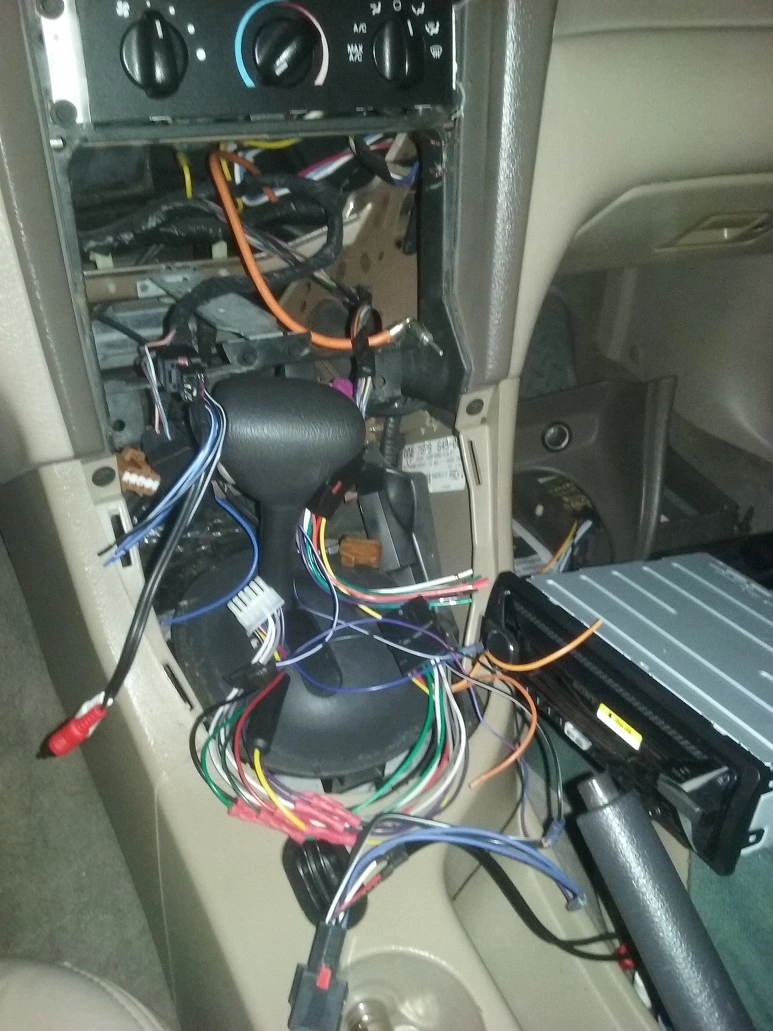

Yes there is a adapter harness, as I stated Crutchfield has technicians that can get you fixed up. They helped with the harness and the correct head unit(which was $2-$3 more than Amazon, just a Sony cheapie with adjustable equalizers), ditto with a ZX2 & Focus & Cobra.
