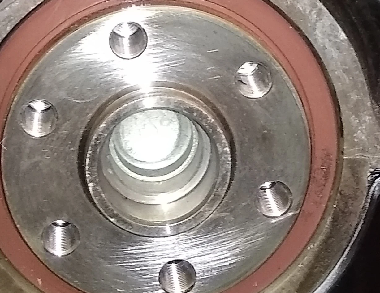

Tell the guy to use plenty of sealer on the crank bolts or you could develop oil leaks from the holes that break through....Out of 6 holes 5 broke through
Good Luck
Good Luck
