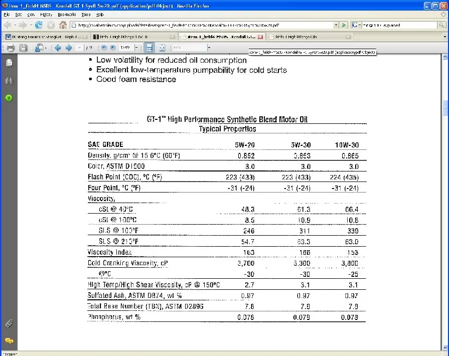

I'd say a 5W-30 if you can find it. 5w-30's usually have a higher flash point and viscosity index (less change in viscosity over temperature change) than 5w-20's. Just try to find spec sheets and locate what you like, it's mostly about brand at that point. Main thing i don't like about Mobil 1 is their poor Viscosity indexing scores, the 10w-30 i use is rated at 145 - which isn't bad, but not great. Wont mean much unless you run you car hard and long, then the viscosity changes significantly (doesnt break down) but alters its lubricating attributes.
Look for comparing charts like this:
Or just ask me to look em up in my e-booklet
