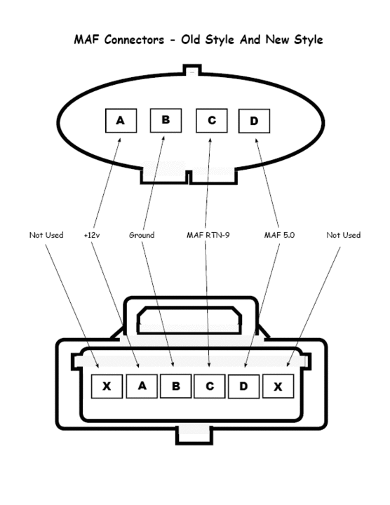

Or you can splice it in yourself...

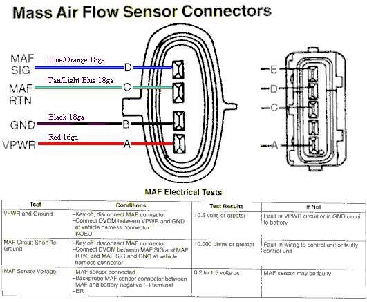

I looked at the RJM website and the one there look likes it has 6 pins. The one on my car has 5 pins. There are 4 wires using A, C, D, and E. So I would need an adapter that has a male 5 pin rectangle connector to a female 4 pin oval.

It looks like the pic JRichker posted is for adapting a Fox MAF to an sn95 Mustang
I'm sure they have a plug for your application.
However,
I haven't seen a 5 plug MAF harness before. Are you sure it isn't a 6-plug?
If the plug isn't a 6 pin, then you may have the wrong part?

I looked at all the links you guys posted and all have 6 pins and mine has 5 pins. I don't know if it is because it being a cali car. On the sensor it has A, B, C, D, and E with B not being used. I could splice it but want to keep stock incase I want to go back.
I just saw a pic for the sensor on 89 and it is the exact same as the 95. Ford must have used a different connector on the 88 cali maf cars. I guess I will have to find a place to make a custom one. Thank for all of your guys help.
