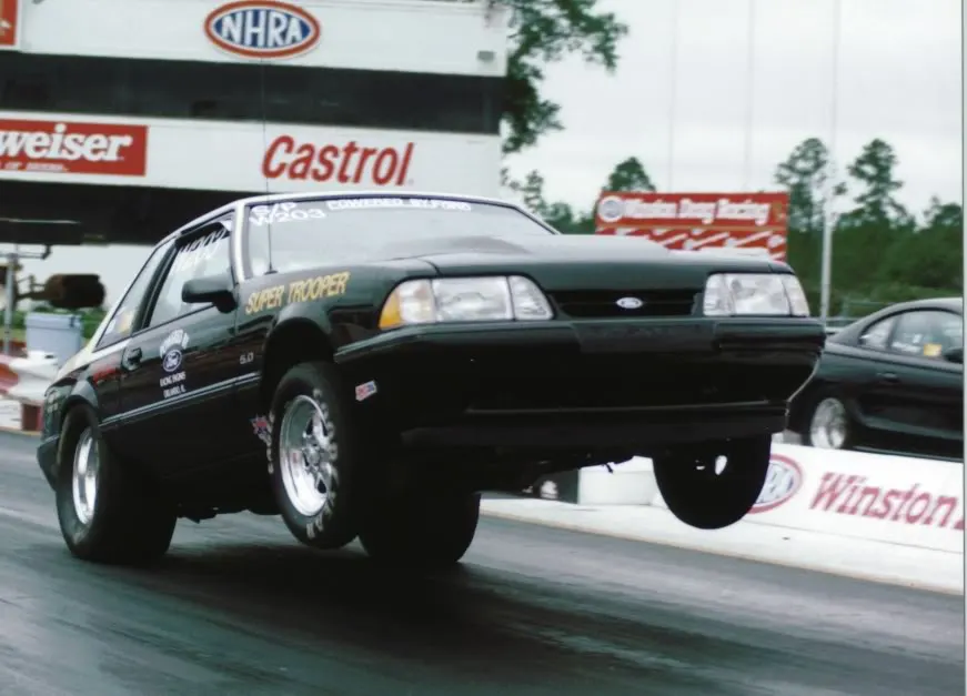

The factory EEC is fairly adaptable to changes. There are some who were successful with using the SD EEC, even on modified engines. SD allows more air flow since no MAF.
I would do your mods & then see how it runs with it. 20 years ago, there were no options at all & tuning was something you did with the radio.
Just about the fastest NA Mustang ever was the Super Trooper, 9's at 140. Don't remember if it was SD or MAF.
