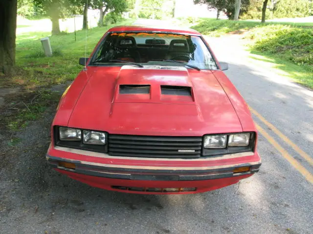

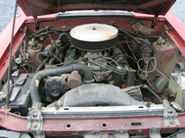

Here's what she started out looking like
