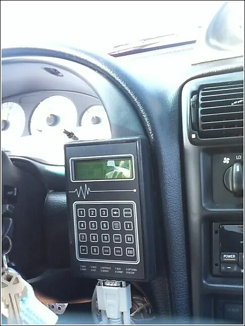

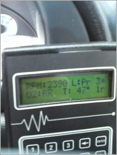

I've owned the PMS and currently we have a twEECer on board. I was more of PMS guy and my buddy is twEECer so he's tuning the car with that currently. I will say it's saved us lots of headache with the 92GT. First off we changed the injectors and you can set injector calibration with the twEECer, nice feature, no need to send a meter back for recal. Also just setting the car up after all the engine mods was a breeze. We didn't have to chase anything down. Set TPS, check injector pulse, check O2's, check MAF, what a tool. Car idles like a champ. Just my two cents.

I had the older version in my 94GT. Worked well for me but I sold the car with it as it was tuned with the 347 stroker. Even had the older style controller. I did like the PMS very much though. However with the twEECer there is data logging and more visual options.

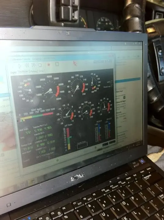

Steven, you can make changes on the fly. I'd Google twEECer and hit up the forums and read up first before you buy. If it's something you can do and have interest then go ahead and purchase. I agree the PMS is steep. I actually found mine here on the Classifieds and bought it for $450 which was the same for a new twEECer at the time. Got some knowledge from the tuning sections here on the forums and by some people running it. In fact I had two members send me their tunes and the car responded and ran like a champ. The twEECer is not a system I'm extremely familiar with, in fact the guy in those pics aren't me (friend, Green94 5.0). He's good with the twEECer. Had a rich condition, turn down the fuel by 15% in 2 seconds. Problem with the MAF fuel / air ratio, realized at that point the stock MAF is not good for our Vortech Supercharger set up so we got a 90MM Lightning MAF. Without the datalogging capability we'd be in real trouble tracing down lots of driveability issues. In our mind the twEECer has paid for itself big time. The car wouldn't even idle after all the engine work. Datalogging found all our issues. Do some reading and see if this is for you.
