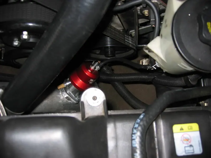

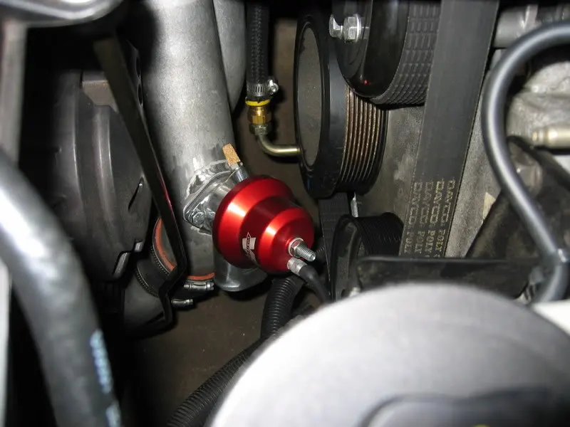

ill take some pics of the set up. the bov is to the atmousphere. it is located down by the intercooler. ill get some more info later.

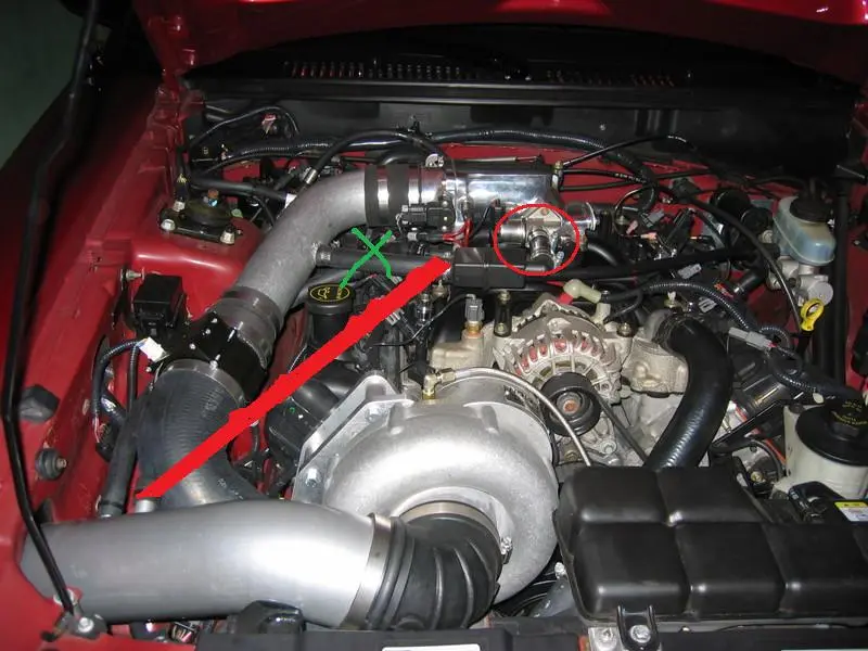

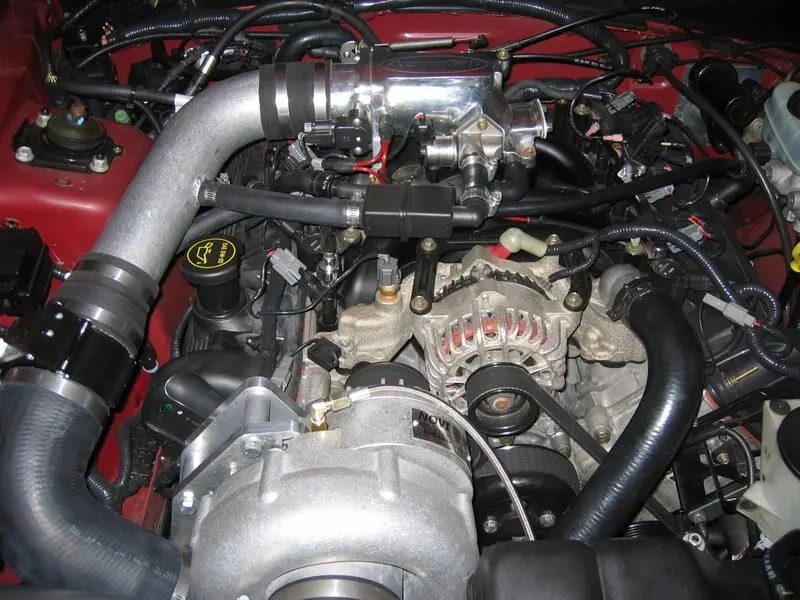

so i have some pics i took after work. i went home after work which was 7 hrs later and the blower and intake plenum were still heat soaked and hot to touch. i could keep my hands on them but they were very warm. i couldnt believe it after 7 hours.
that is how bad the heat soak is i guess bbefore the car starts acting strange witht he idle and running rich. im scared all this heat is going to break things mainley my engine.
anyway, heres som pics of the set up.....i think there is a air flow problem. either the air is not getting cooled, the air is getting blocked, or something is falty and not letting the air through.:shrug:
the bov is located down toward the drivers side wheel
Not sure about the other stuff...but dude your IAC is plugged into the discharge pipe you DONT want that! You need to reroute that down to the powerpipe (inlet) where that thing is capped off, that's where its supposed to go! Boosting and IAC will make it not work/fail.
wait, is the iac the white sensor plugged into the maf? because i asked my builder about that and he said that the iac was built in the maf for this new abaco model. he said it should be that way because i run the blowthrough set up.
are you saying that even with that abaco maf and the blow through that the maf should be on the boost pipe? what would then plug into the maf where the sensor is?
