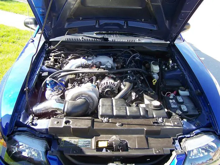

major blower heat soak! cant seem to figure it out?
He's right, the IAC should be working under vacuum, not boost. That's proly why it wont idle. You shouldn't have it set up like stock intake there
Its ok how it is. That is how all the procharger setups are. My car idles fine, and it is just like that. The only thing that you have to reroute to the intake side of the blower is the breather from the valve cover. You just have tuning issues. I would take it to a different shop, they should have been able to dial it in on the dyno in a day. Good luck.

however, is the iac set up right or wrong? do you guys see anything wrong with this set up? the way he has things done, routed, mounted?

do you guys see anything wrong? where is the iac supposed to be? i got two different answers! dont forget this is a blowthrough set up. its a bit different.

IMO the IAC tubing should be routed like I drew in the picture. Simply because as soon as your blow off closes boost is being applied to both sides of the IAC - that just can't be good for it. Like the one guy said, that's how prochargers run it, but I think you would get more accurate amounts of air through the IAC it if its drawing the air through on its own, and not having air forced in by the blower.

also i tried to find a thread that there were people posting up pics of their blower setups so i could look at tham for comparison, but i could not find it. maybe it was on another site but i still didnt find it. anyway i searched through a couple of pics on googl and they all have the iac put back into the stock location on the inlet pipe.:shrug:
I have mine routed back to the powerpipe, yeah.
oh yea, i see what you did there benny! hmmmm i never really see them like that.
i wonder if that can help. i mentioned it to him but he didnt seem to think it would help. ill have to bring it up again.
i checked out some pics of the novi charged saleen here on the site and it is set up the exact same way as far as the iac and the oil feed line somone else mentioned. those things should not be the problem if hes runnin g them like that.
however, he is a draw through set up so maybe there is a difference.
