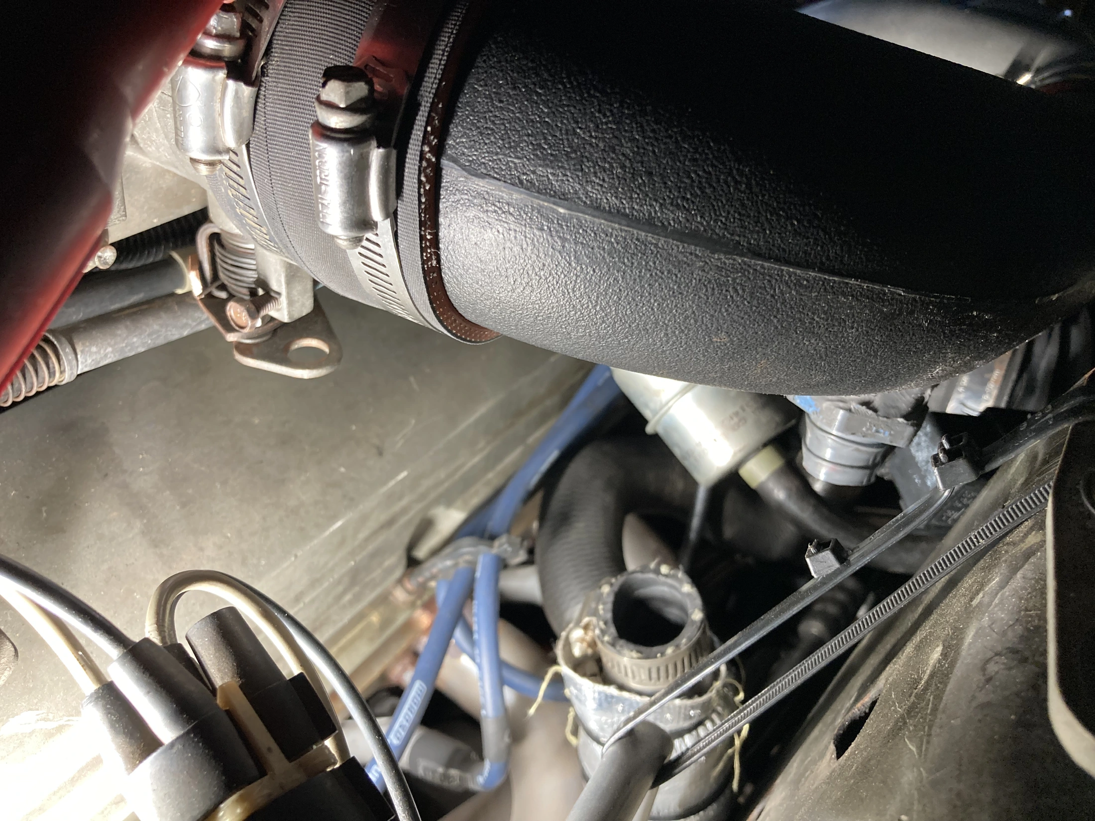

I found the problem. Duh! My cheesy bypass valve setup blew the hose off.

I think I will change out the bypass hoses to a different configuration. My goal will be attempting to get the valve as far away from the hot exhaust as reasonably possible. Currently its pretty close to the header

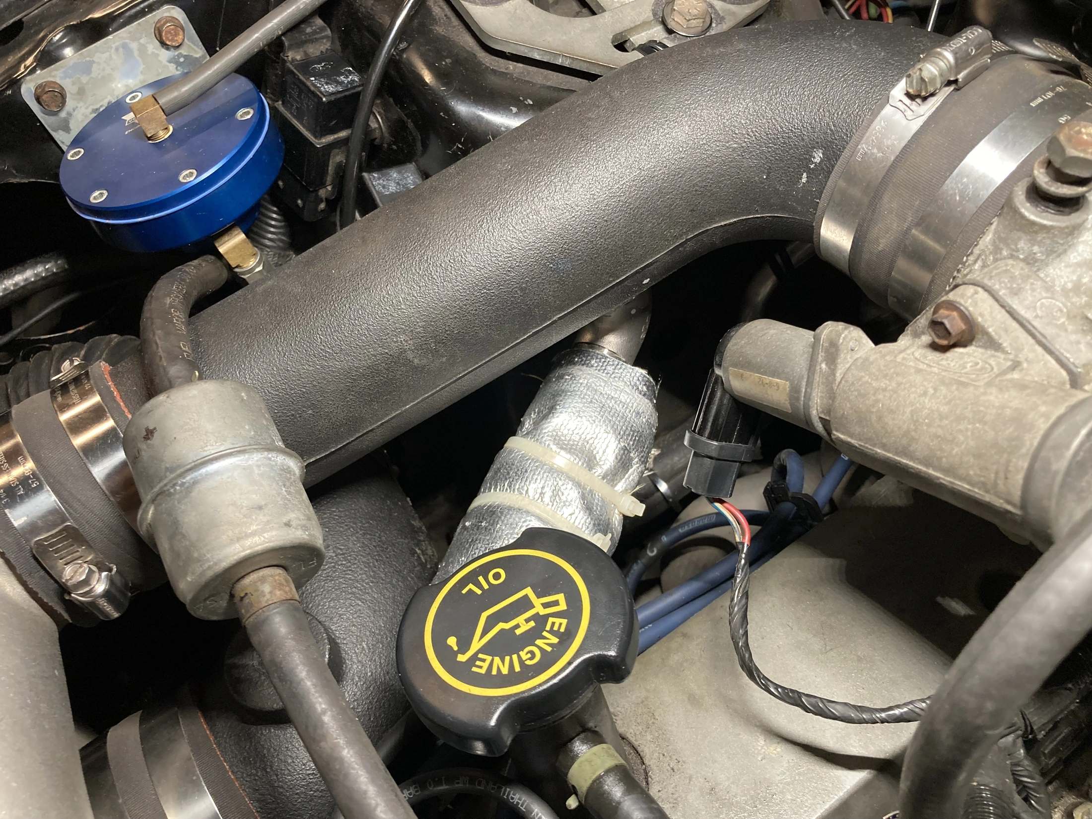

Ok I have the bypass valve relocated at least 4” farther away from the exhaust header. I have it wrapped with heat shielding fabric. I used 90 degree elbow fittings of stainless steel in both air pipes. It still looks cheesy but I promise you that it’s rock solid and won’t blow the hose off any more.
