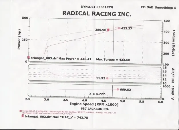

this is my first graph when we only ran it to 5500rpm and made 423 hp. i dont know if he changed anything when he ran it to 5800 and and made 502rwhp, but i dont think so. i assume the a/f was tha same.
how does it look? is that where it is supposed to be?
You want your AFR to be under 12, so if its 11.92, I would say its fine.

If your car was running that pig rich and causing all these problems you would see it on the dyno. Are you getting any check engine lights?
After looking at the dyno sheet, the tune looks great. 11.90 pretty much across the board. Nice straight line. No weird spikes. MAF counts look good. Nowhere near saturation. 60 pond injectors and the cobra pumps will easily support the power.
