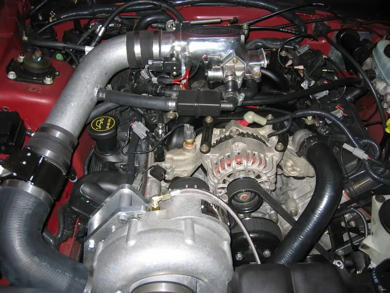

well, my new tuner says that the sct tuning fixed the current proble. however, there is a new one hes trying to get to the bottom of. @ around 5500 rpm the maf signal starts to go crazy and jump up and down and all over the place making it hard for him to get an accurate air fuel reading. :shrug: he says its when the boost really hits hard. however, his boost numbers are lower at this point then the other guys. he says im only making 11 or 12 psi at 5500. the old tuner told me 15...strange. anyway, i dont care about that right now however his hp numbers are about 25rwhp LOWER then the old guys right now. well hope he figures it out then we will see what this ting makes.

ITS DOWN BY THE DRIVERS SIDE FENDER.
he cant figure out why the everything gets crazy in the upper rpm. he thinks it might be the meter. so he wants to switch that to sct too but then i have to get an sct and tubing to make it fit cause its different then the abaco, and then he needs to tune again even to see if that is the problem. im just out of cash.
right now it sits at 500rwhp @ 6000 rpm but the a/f is unstable at that level. that is with less timing in the tune. he wont put the full tune together with about 2 more degrees of timing until we get the upper a/f issues and the crazy maf signal ironed out. i might have to just let it be for now....broke:mad:
What did I tell you about your MAF being located that close behind a bend in the tubing? :D
Move the meter up and your problems will go away. The air is flowing faster on the outer edge of the pipe, and the inner edge is going slower. The air is entering your meter like this and mean while just starting to try and straighten out. This causes ALOT of turbulence, and thus your wacky readings.
Easy fix.
Here is the pic I am talking about....just imagine hurricane force winds going through that pipe, and how jacked up the air direction will be where your MAF is.
Cut your aluminum pipe about 3-4 inches, to where the back of the rubber coupling for your MAF is about 3/4-1 inch away from the IAC hose. Get another rubber elbo thats longer, or use the piece you cut off to bridge the gap with another silicon connector.

heres the verdict. the car is fixed of the original problem. you guys are right about the meter and how close to the bend it is. that has to be changed and it will. right now it is driving fine and im going to keep it that way for over the winter. i cant get into the boost too hard and it has timing pulled because it detonated with 15 degrees. that is a whole seperate issue i was unaware of. 14 degrees is in it now and it is ok for now..

Your problem with detonation is also stemming from your MAF placement. With your MAF getting wacky turbulent readings like that , a nice strange little thing will happen. Since timing is based on engine LOAD and RPM....when the MAF doesnt see all the air coming in, it thinks less air is there so obviously less fuel....thus the leaning, but at the same time it bumps UP your timing due to it shifting into another load cell thats for lower airflows, and higher timing. Less air means less energy, means less heat, means the engine can accept more timing. Now with the MAF flickering around and giving false readings, your timing can jump around a pretty large amount very rapidly.
THAT combined with the leaning condition thats also caused = detonation. :nice:
