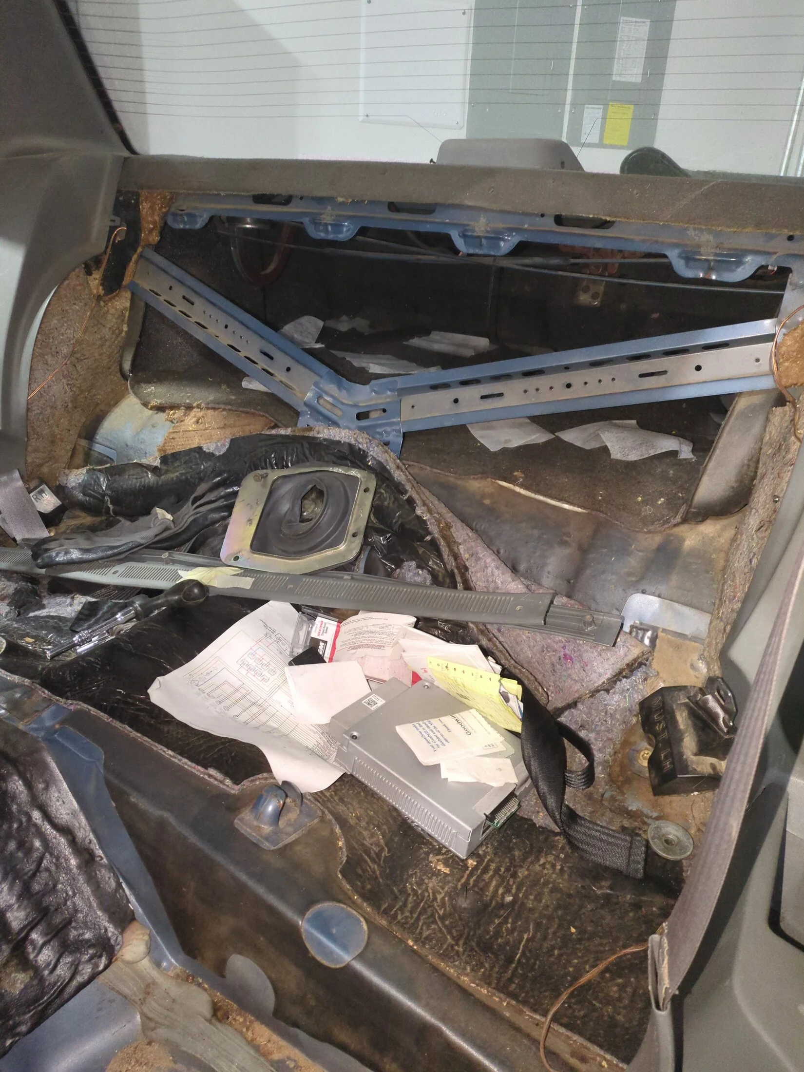

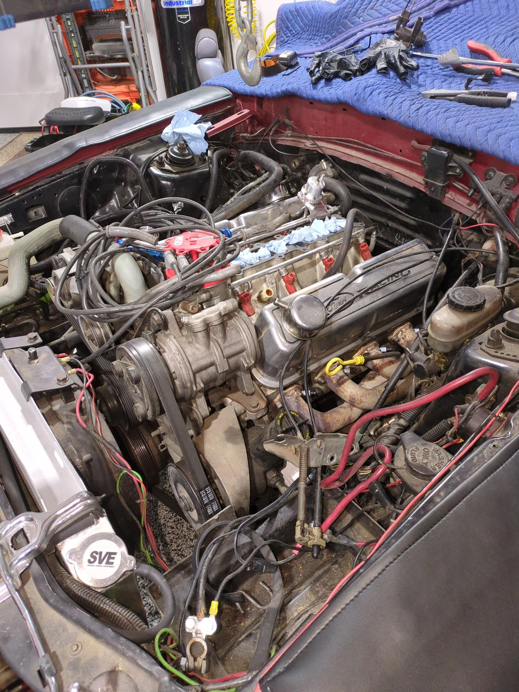

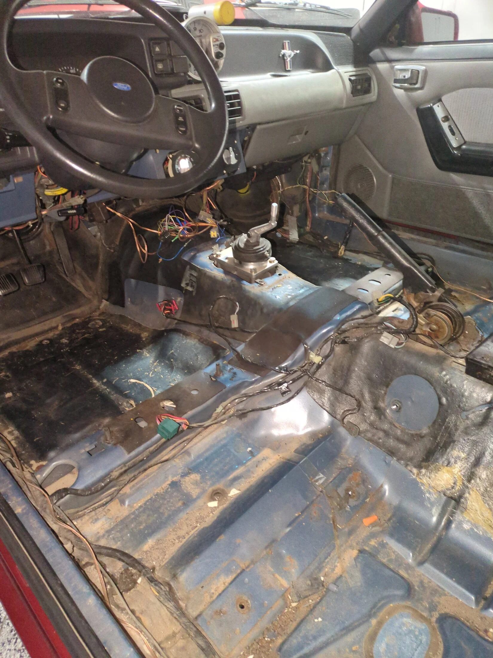

I'm back on this project. Pulled the interior and should have the motor and tranny out next week.

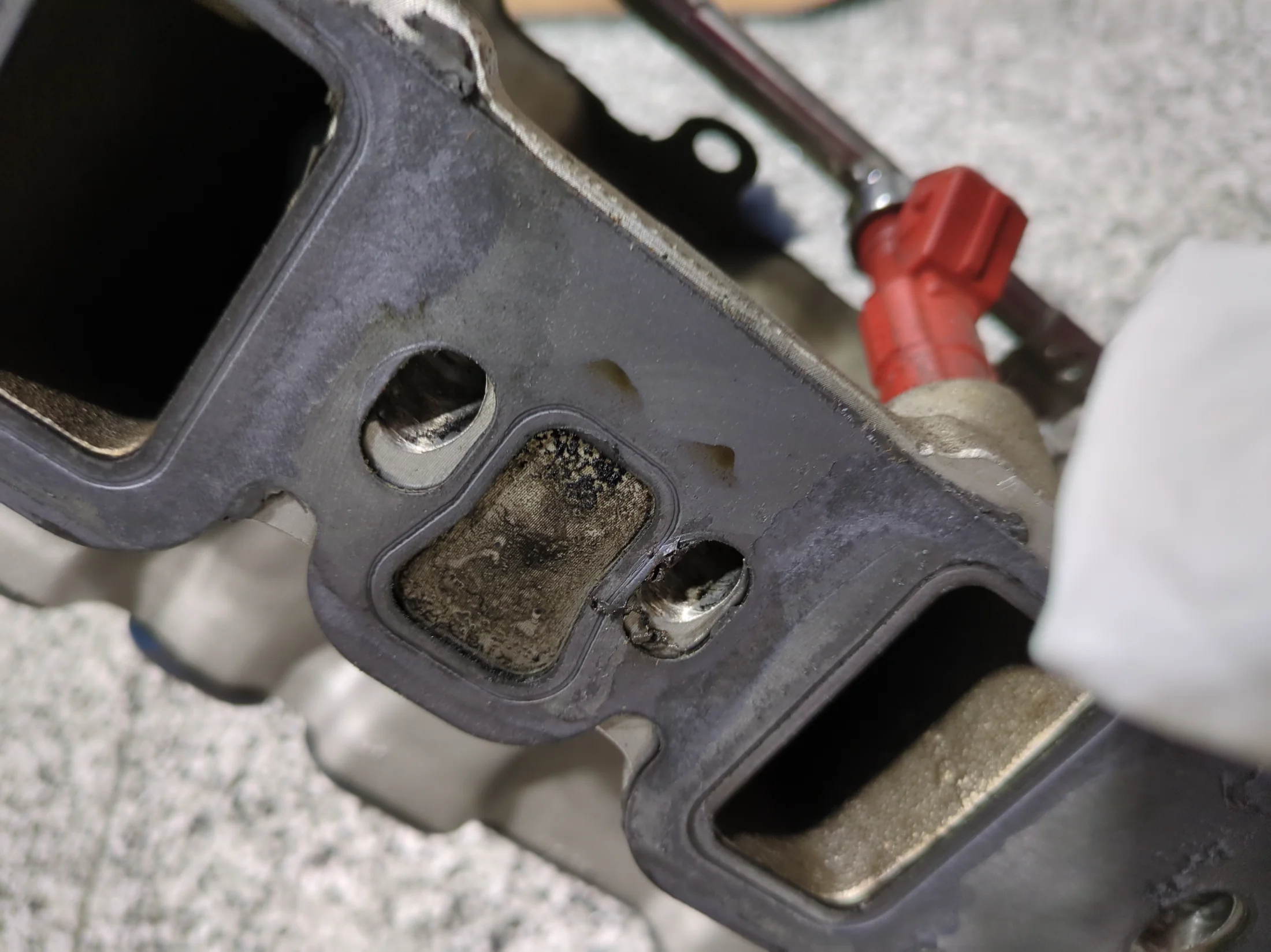

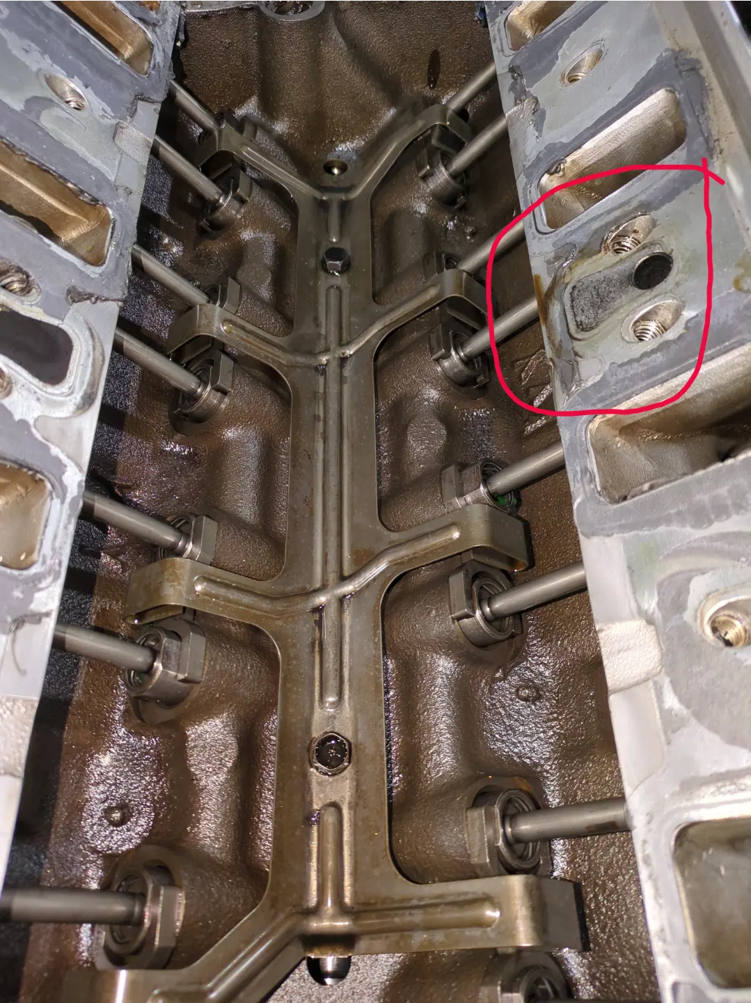

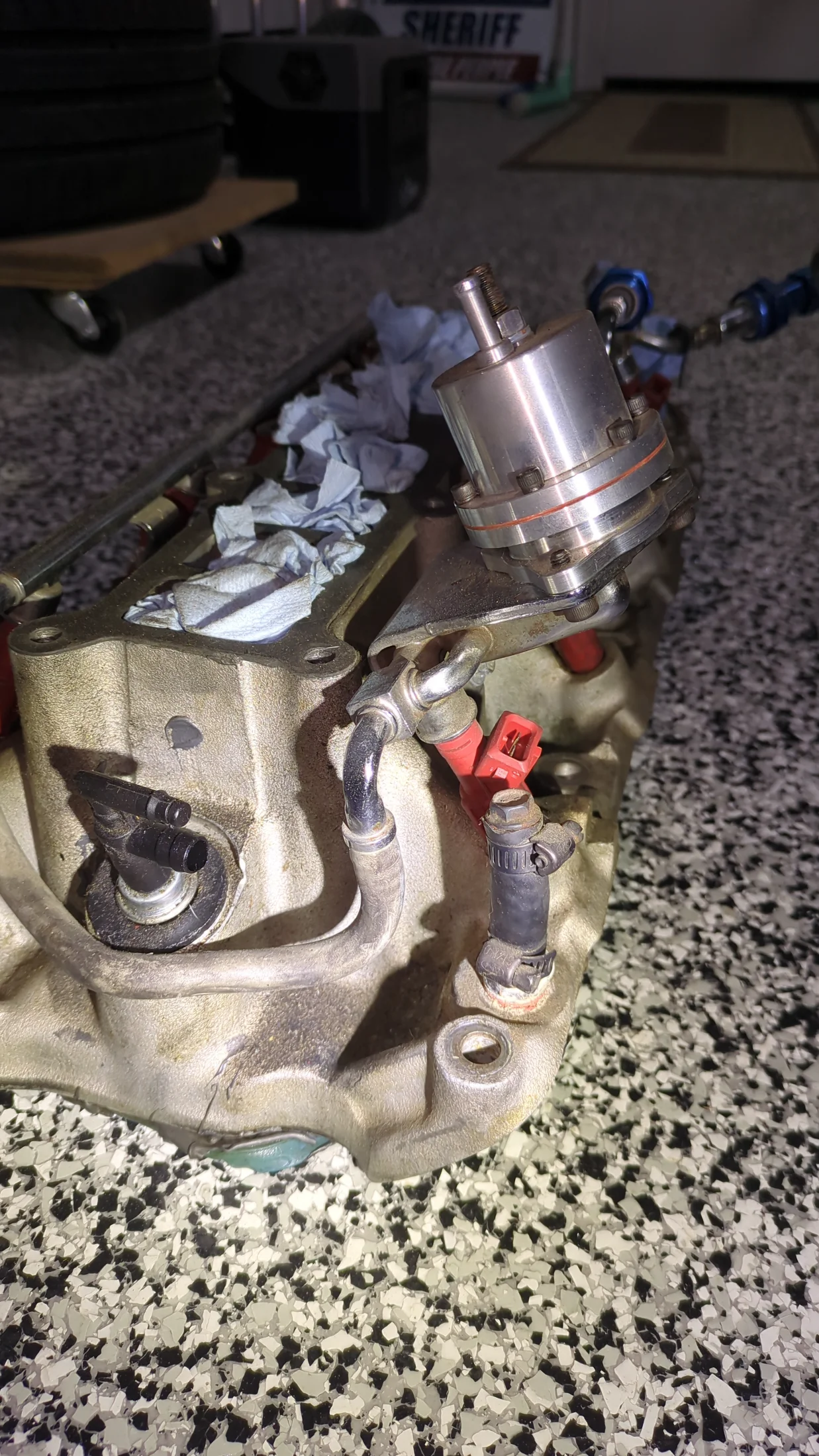

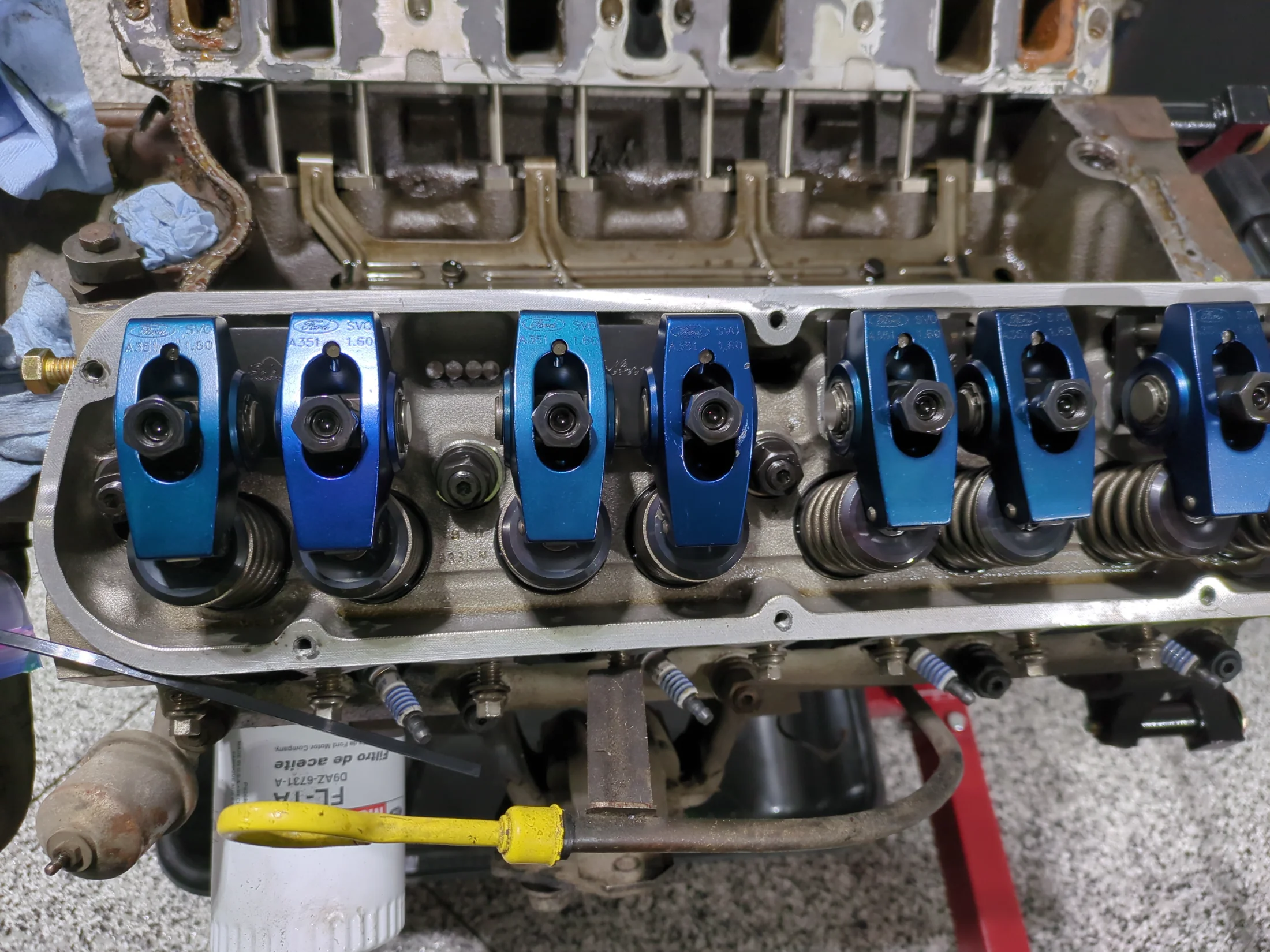

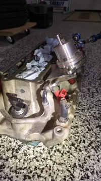

I pulled my lowering intake off and noticed some oil leaking in. A little more background about this engine, has great power thru all the rpm's , however once it got up to temp the some oil would leak into the cylinder. My suspicion were a valve seal, but just unsure at this point. Please fire back some questions.
EGR ports on the head. Likely coming down from the intake getting sucked through the EGR? Is it functional? Blocked off?
I believe it was blocked off. Do people usually block it off?

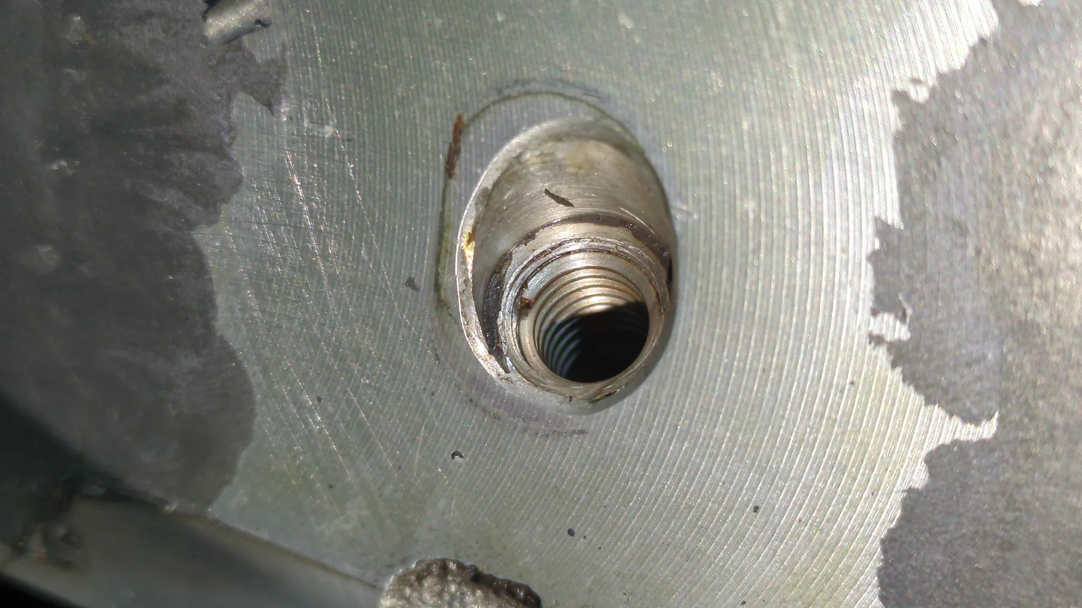

That bolt hole in the circle looks like it has a heilicoil ?
Good eye, They all look like they have heli-coil. :cautious:
Whatever you end up doing get a stud kit for the lower intake to the heads. You will thank me later.
Now, I'm understanding why then need studs.

When the lower gets torqued down with bolts there is both torsional and tension forces acting on the threads. With studs it is strictly tension which is why you will get a better torque. As always heat cycle the motor and retorque the head bolts or studs, the lower intake bolts or studs, and the exhaust header bolts if you have replaced all those gaskets.
I did a semi- leak down test. The (HF) Horrible Freight leak down gauge was not working correctly, so I pressurize each cylinder @ 100 psi and could not feel or hear any leaks. I don't think buying another leak down tester is going to help much, however I could be wrong. What should I try next?

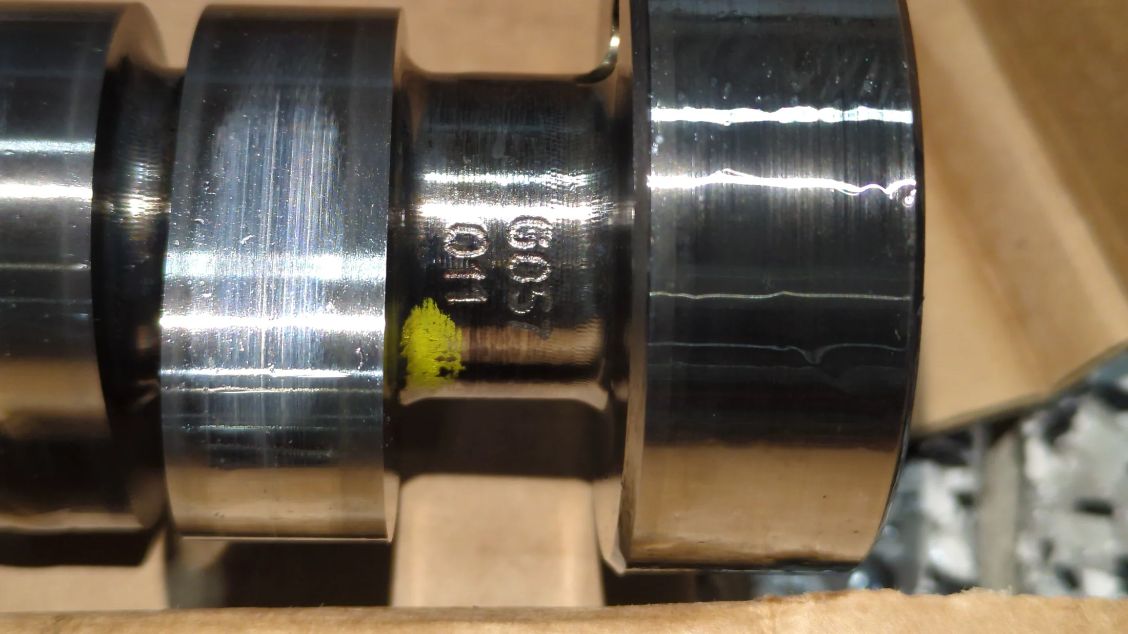

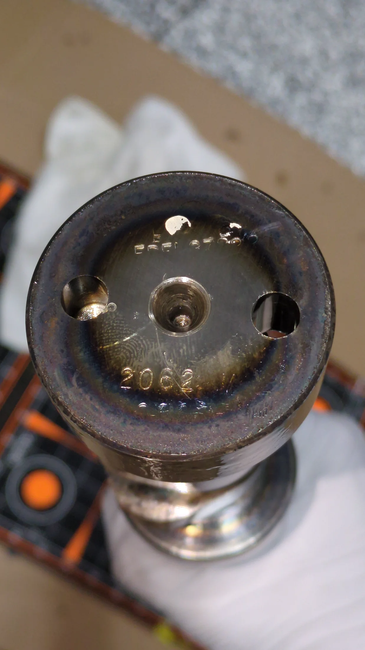

I just pulled the heads off and will send them to a machine shop. I searched all over the internet trying to identify this cam with no luck. What do you guys think? Only numbers I could read, 2062 M and 6057011
