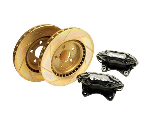

The Cobra R Brembo kit is hellishly expensive.
MSRP is $1,150
Also, it requires greater backspacing than a GT rim typically has. The backspacing for the brake kit is 6.12"
Its an awesome kit though :nice:
http://www.fordracingparts.com/parts/part_details.asp?PartKeyField=5819
