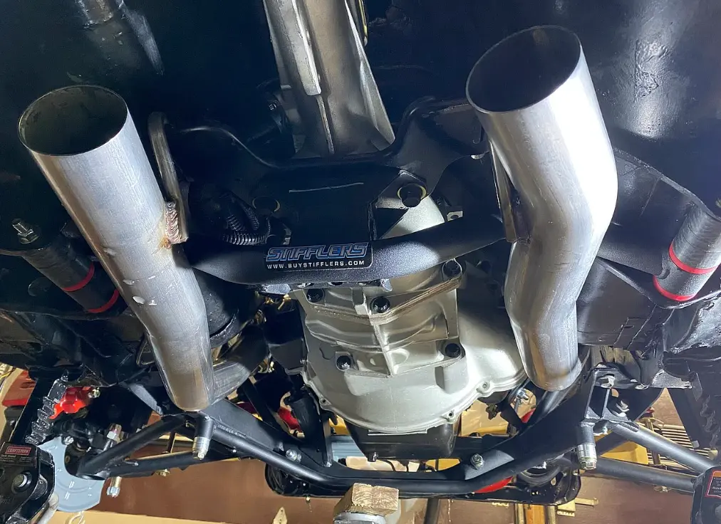

Ahh I was looking at Stifflers. Nice!!
In prep for these polys, I put a floor jack with a piece of wood under the end of the trans just to relieve the pressure and support it while I take out the x-member.
All bolts came off pretty easy. I'm hoping the Xm will line back up with the new bushings installed without any mods. I'm sure these old bushings have been loose and crushed for a long time.

Worse scenario is unbolting it from the transmission and removing it from the car to inspect and install the bushings on your workbench. Do the new bushings come with new bolts?? If not a good time to clean up ( wire wheel) the old ones and install some silicone grease on them...
I used a stifflers also as my old one was single hump for single exhaust..
I bolted it up to 0ne side, swung it up to the other side bolted it, then bolted the transmission to it... Super easy..
Very nice! These Stifflers are definitely the way to go if you are looking to upgrade for sure!
I don't think the new bushings come with new hardware so I'll clean them up and reuse like you're saying.
Never realized these x-members made a big difference.
It never made any sense though that you have a rubber or poly support to the trans aaand more bushings and movement on the Xm.
As 5L5 said before, the Xm should never move.

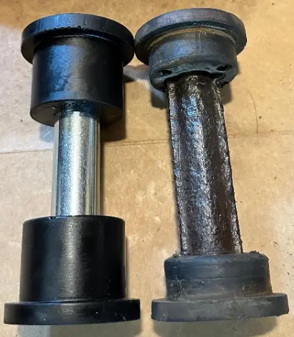

Use some scotch-brite pad and clean up the ID of the tube where they will install. Use the supplied (hopefully they come with some) grease and they should pop right in. Been running the stock crossmember with them for a looong time and zero issues.
I ended up grinding the tack welds off mine as it made life a lot easier installing the cross member and getting things to line up. If you do this then be sure to paint things as it will rust quick.
Good to know. I'm sure the IDs are all gunked up. Hopefully not rusted or pitted. I believe these bushings do come with grease so I'll be sure to use it for install.

Worse scenario...
https://lmr.com/item/LRS-6023HDW/79-93-Mustang-Trans-Cross-Member-Bolt-Nut-Kit

Just wanted to give this thread and all of you an update. I was able to change out the X Member bushings from stock to Prothanes and it was pretty easy as everyone was stating. The stock ones pushed right out and the new ones pushed right in with a little elbow grease. What a dramatic difference in appearance.

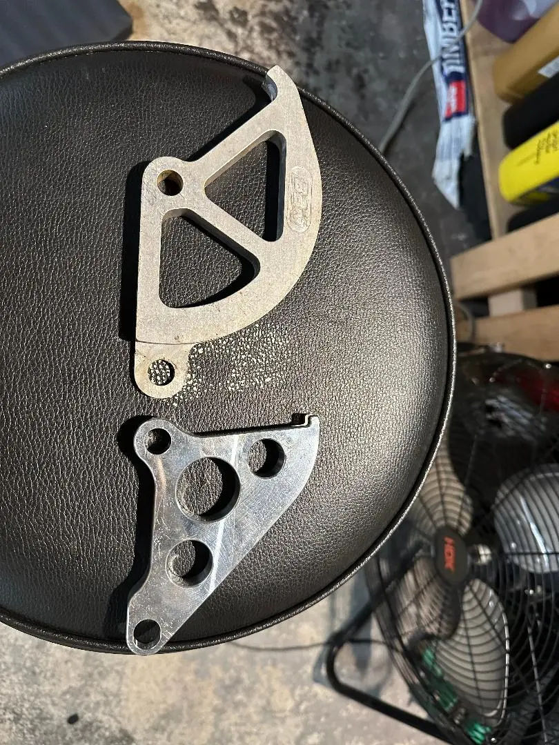

I haven't been able to road test just yet. Since I had the h-pipe down, I figured I would replace the clutch cable and install MM's quadrant and firewall adjuster.
There was an old BBK in there already. Left in the pic.

UPDATE AND CLOSURE
After the road test, I was able to conclude that all the movement I was having was indeed from the worn out old / stock trans x-member bushings.
The prothans really made a positive dramatic difference with very little movement at all.
The MM quadrant, FWA and OEM non-adjustable cable came out great. The pedal starts to grab about 1 1/2" off the follow and is a smooth travel in total.
It helped in relieving some of the hard pedal feeling but it still feels like a manual cable clutch pedal. I assume that is to be expected with a manual cable clutch pedal in a fox.
