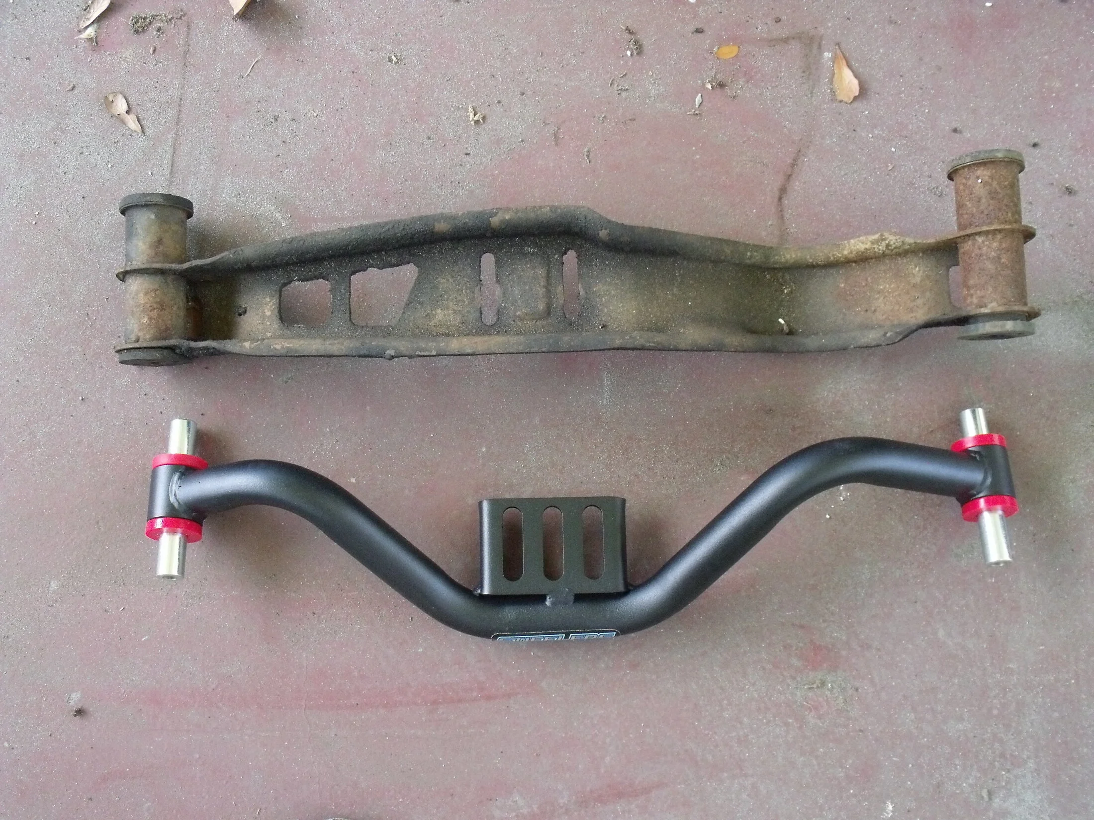

I used a stifflers also as my old one was single hump for single exhaust..
I bolted it up to 0ne side, swung it up to the other side bolted it, then bolted the transmission to it... Super easy..
Use some scotch-brite pad and clean up the ID of the tube where they will install. Use the supplied (hopefully they come with some) grease and they should pop right in. Been running the stock crossmember with them for a looong time and zero issues.
I ended up grinding the tack welds off mine as it made life a lot easier installing the cross member and getting things to line up. If you do this then be sure to paint things as it will rust quick.
