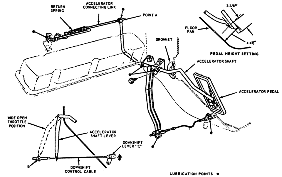

The carb will be the same for a 65-66 ,the passing lever is a cable from the pedal to the leaver on the transmission ..you will not need a vacuum can ,that was 67 up and for the air conditioning .The vacuum will come from the back of the intake and down to the modulator valve on the transmission .

this is a diagram of the easiest passing gear set up to install
