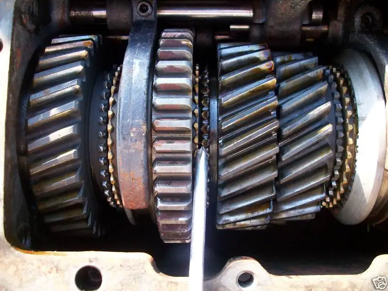

it has a tag on it that reads HEH D 022791, said it came from a 1964 Galxie with a 390 here is a picture of the problem gear/sync thing.

that being said and shown... can you give me some ideas as to what the different gears ratios were for this model (if it is even that model). also since that part is bad and will likely need to pull everything out to fix (why not just do a rebuild) any reason i cant change up the ratios a little bit and some recommendations on gears for this and my rear?! I know i ask a lot of y'all but y'all know so much more than me! haha thanks for all the help y'all give me!

Sorry to bust your bubble, but that Toploader ain't gonna fit your 66. The Galaxie Toploader is 3" longer and the 390 specific Toploaders have a shorter front snout on the input shaft that prevents it from extending into the pilot bearing/bushing when used with a small block bellhousing.In addition to that, it's probably also a close ratio unit with the taller 2.32 first gear, you want a wide ratio unit with the 2.78 1st. There were only two gear spread combinations for production Toploaders, these are it. rbhom has a small block toploader for sale for about the same price, PM him.
