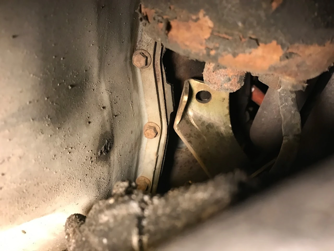

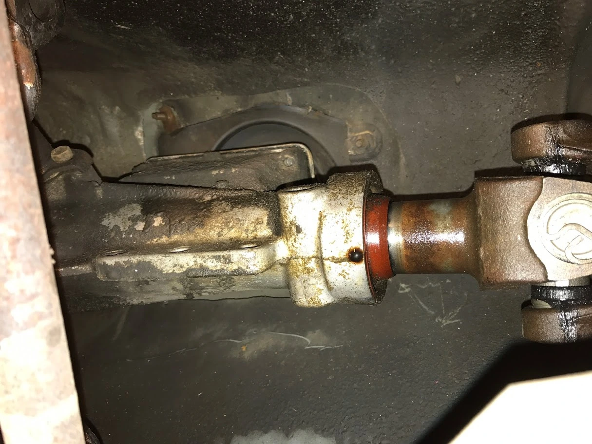

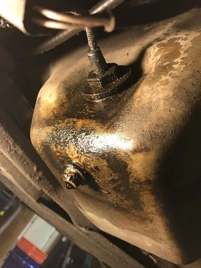

So I knew I had a rear main leak and was prepping to replace it. So last night I finally got under the car and found some other items that I need to address.
See the pics but in addition to the rear main I think I have these others if someone can help me confirm.:
  • Oil level sending unit. Also need to drain plug.
  • T-5 leaking through tail shaft (it is whining so I am sure they ran this low before which is something else I am going to tear into).

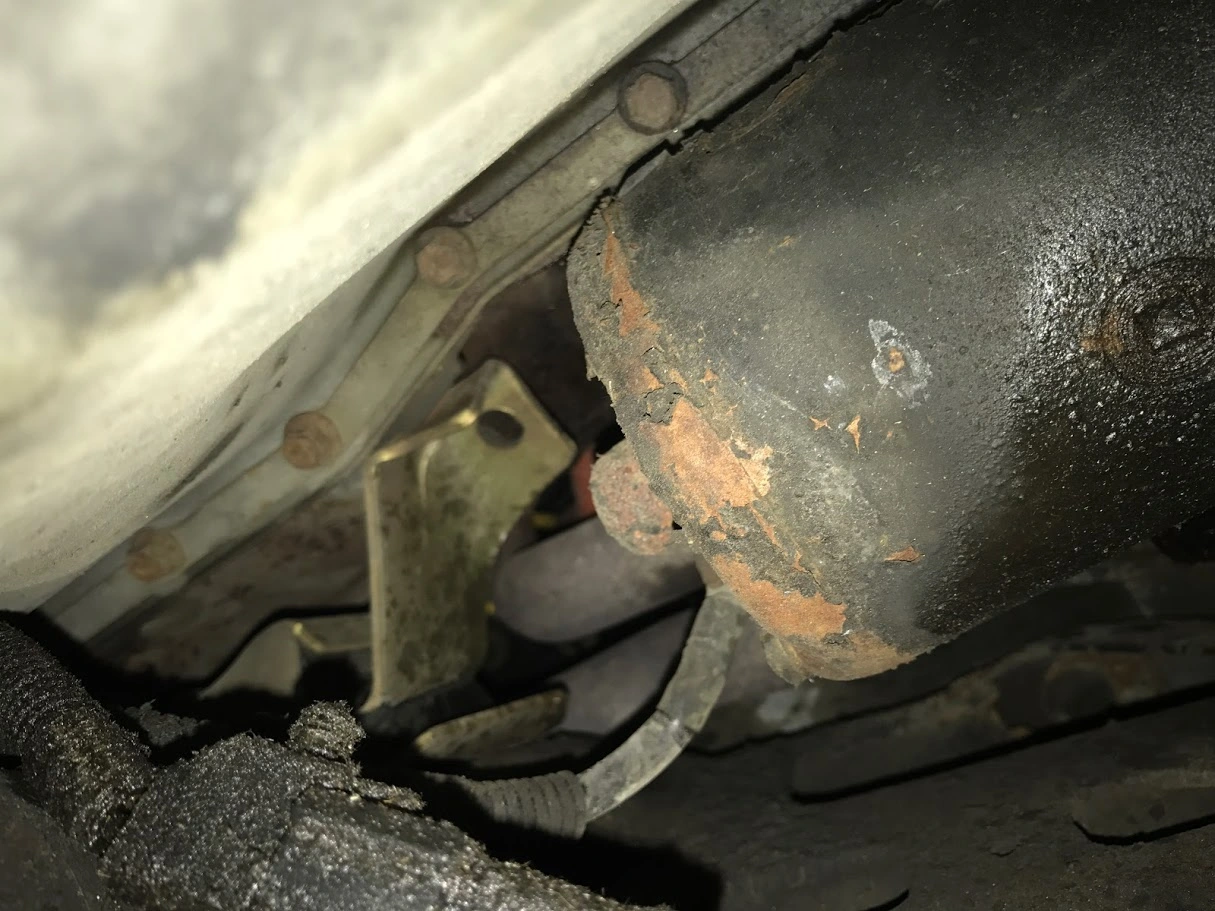

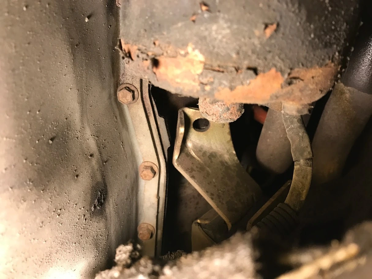

One thing that caught me by surprise was the motor mount. They look to be fairly new but you can see it is missing the rearward bolt and it doesn't even match up with the hole.
Does this mean that is the incorrect motor mount? Installed incorrectly? Etc..

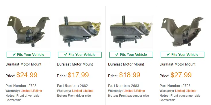

Convertible mounts are actually preferred as they sit slightly lower, and are a bit stiffer to use. Many aftermarket mounts model the vert mounts. I believe Ford discontinued the hardtop mounts long before the vert mounts and made them the universal replacement.
Anyway, what prob happened is the weight of the engine has slightly bent the mount due to it not being properly bolted up. The bolt could have vibrated our, or the PO got lazy, who knows. Ideally I like to bolt them to engine first, and then bolt the mount to the K-member.
As far as your oil pan leaks, they do make a new gasket for the sensor. I think I got it from rockauto, along with gaskets for the oil pan plugs. I've experimented with different plugs and found that a pair of plugs I got from AZ with rubber impregnated around the washer have worked pretty well to prevent pan leaks.
Rear T-5 bushing could be an issue. Grab the yoke and wiggle it around. Should be no play, if it does move, the bushing needs to get change. To do it with the trans together requires a unique tool, otherwise you need to pull the tailhousing off. If there's no play, replace the seal and call it a day. I recommend when you remove the D/S, to throw the 4 bolts away and get 4 new ones.
Reactions: Shakerhood
The yoke definitely has play and I think when I replaced the U-Joints it had visible grooves in the yoke (figured I would deal with it when I did rear main). I will be pulling the trans out to check the main shaft for galling due to whine.
I will try and find the gasket for the sensor and will get a new drain plug as I had a heck of a time getting out last time.
I have had a lot of the same issues with my 91. You definitely have to vert mounts just like I used on mine. The problem is they usually don't fit exactly right and require some trimming. My guess is whoever installed them didn't trim the mounts to fit. Instead they just left the bolt out.
My oil level sensor was also leaking but not around the gasket. It was leaking internally. I used to the elimination plug from LMR instead of fiddling with a new $60 sensor.

Okay I need some ideas on how to get that motor mount aligned. I have put a ratchet strap in an attempt to pull and them use some banging to knock it over but it isn't budging. I have the other bolts loose on all mounts. I find it crazy this thing is off this much. And not sure why the po just thought it was okay to leave it like this.
It's possible the mounts are wrong. The drivers and passengers side are different but look similar. They could have put them on the wrong side or used 2 passenger or driver mounts.
The bolt holes in my drivers side mount would line up due to the mount hitting the block so a little trimming was required.
Since I have the trans and everything out I figure I am at a bit of disadvantage of pulling these out right now without a cherry picker. So I am going to work on getting the rear main and trans stuff done and will pull these and replace them when I have some rear support by the trans to also help align the motor. I removed the one bolt and as soon as I did that mount basically twisted a 1/4 inch. Something isn't right so will probably pull them both and replace them.
