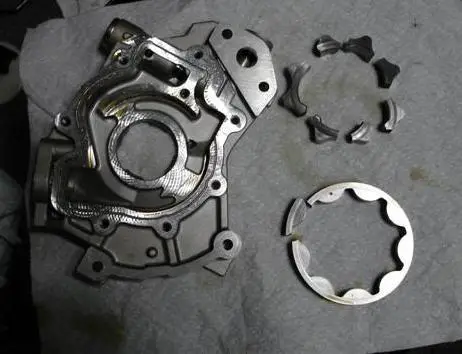

underdrive pulleys + factory oil pump may =
i learned this lesson twice before changing to a melling pump and factory pulleys. i am kind of retarded though.
every time I've heard of that it was with a piggyback set or a crank pully that wasn't damped. Were you running the factory damper bolted on the underdrive crank pulley, no damper at all, or the Steeda damped crank pulley type?
every time I've herd of that it was with a piggyback set or a crank puly that wasn't damped. Were you running the factory damper bolted on the underdrive crank pulley, no damper at all, or the Steeda damped crank pulley type?
to be honest i dont know what brand the pulleys were but they were solid aluminum and kind of looked like these but not that color, mine were a red-ish / marron-ish color. they came on my car when i bought it.
they completely replaced the factory damper, not piggyback.
