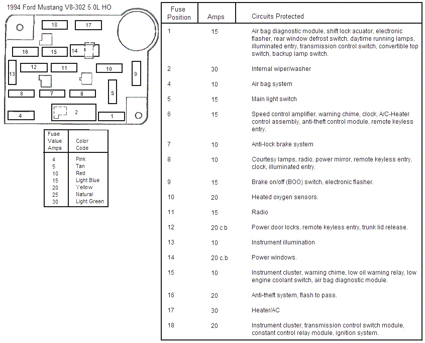

Hello,
I am having an issue with my 95...The marker lights and rear lights will sometimes stay on and kill my battery. It doesn't happen all the time, but it has been more frequent lately. I finally decided to pull the headlight fuse today when they wouldn't shut off, and that was the only way I was able to get them off. When i plugged the fuse back in, they came back on.
I just replaced the headlight switch about 9 months ago and this did occasionally happen before the switch was replaced.
I replaced the switch in the first place because the headlights would flicker on and off.
Anyone have any ideas???
