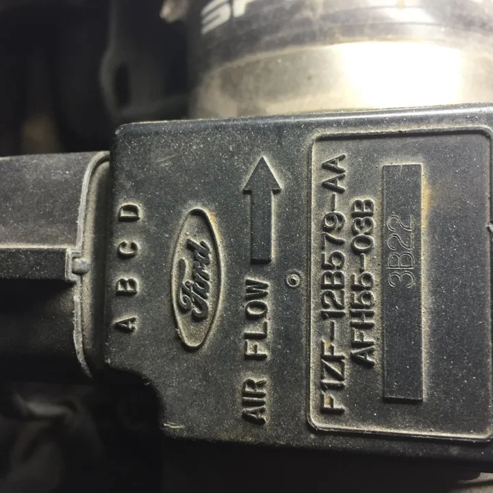

What do you mean by the right MAF- do you mean diameter or injector? Is it a Ford or aftermarket unit? If Ford. post the part number on top of it. The MAF is matched to the computer not the injectors with a Ford MAF. Most 5.0 mustangs except for the Cobra have a EEC that is for 19lb injectors and MAF. The Cobra is matched to 24lbers.

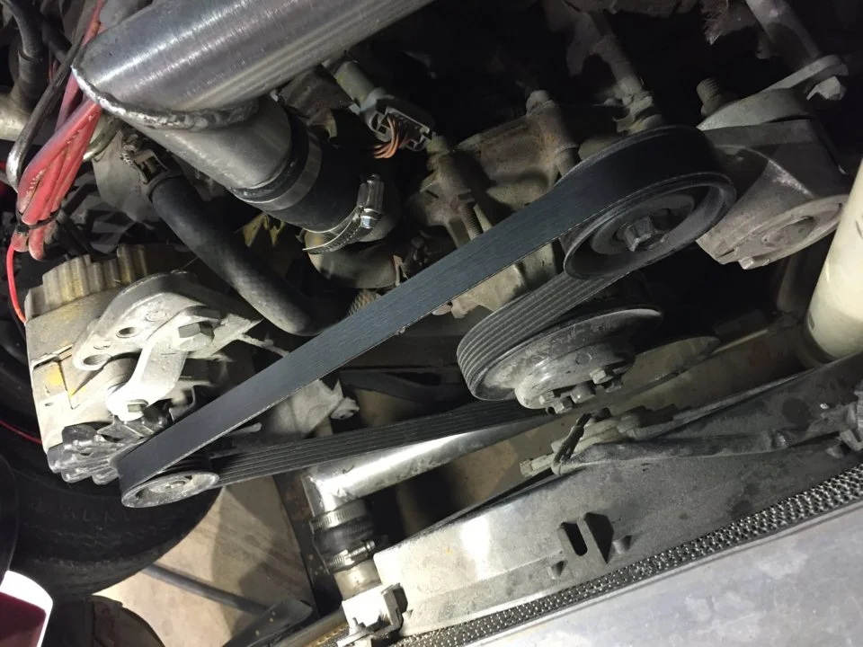

I'd like a picture of how your Serp belt is routed with only an alt, crank and WP and some sort of belt tensioning device.

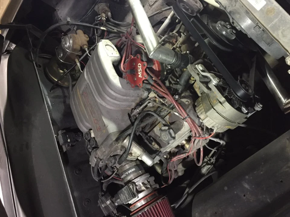

Thank for the pictures! :nice: This helps ALOT.

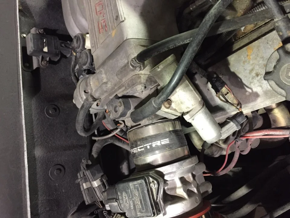

You have quite a bit going on there that is just not good. I'm not trying to offend and I realize that you have inherited someone else's nightmare, the things done so far all read fail.
I will let the guys get to work in helping you get this figured out. They will be better able to follow along consistently.
The GOOD news is that you are in the right place to figure out how to work this all out. :)
Thanks for the pic of the serp belt. I've never seen the tension arm setup like that.
One thing I see that I believe is hurting you is your MAF and filter is mounted directly onto your throttle body. You want some distance between the MAF and TB so you'll need to get an intake pipe and mount the MAF more upstream. I also believe the air filter should not be mounted directly onto your MAF as this could result in turbulent air.

Also pull the plugs for the cylinders that are reading cooler than the others. You may have a faulty injector, bad plug or bad plug wires. Start the car in the dark and look for arcing wires.

The one thing I would try to do is to locate the MAF and air filter in some place that can pick up cool, non- turbulent air. The Fox body Mustangs pick it up from the inner fenderwell. Some PVC pipe from Home Depot, Lowes or ACE Hardware may help you to fabricate a more suitable cold air intake system.
Just look up a BBK cold air intake for a mustang 5.0 and that should give you an idea. There are special MAF's out there that you can directly mount a filter to, I think ProM makes them and their called a Bullet.
Also, the MAF is calibrated for a specific injector size only. A MAF for 19# injectors will not work well with 24# injectors. You will have idling and drivability problems if you mix and match. Your motor should be good with 19's

It's good to see that at least your water pump is spinning in the right direction. Sometimes they're routed wrong. hehe
