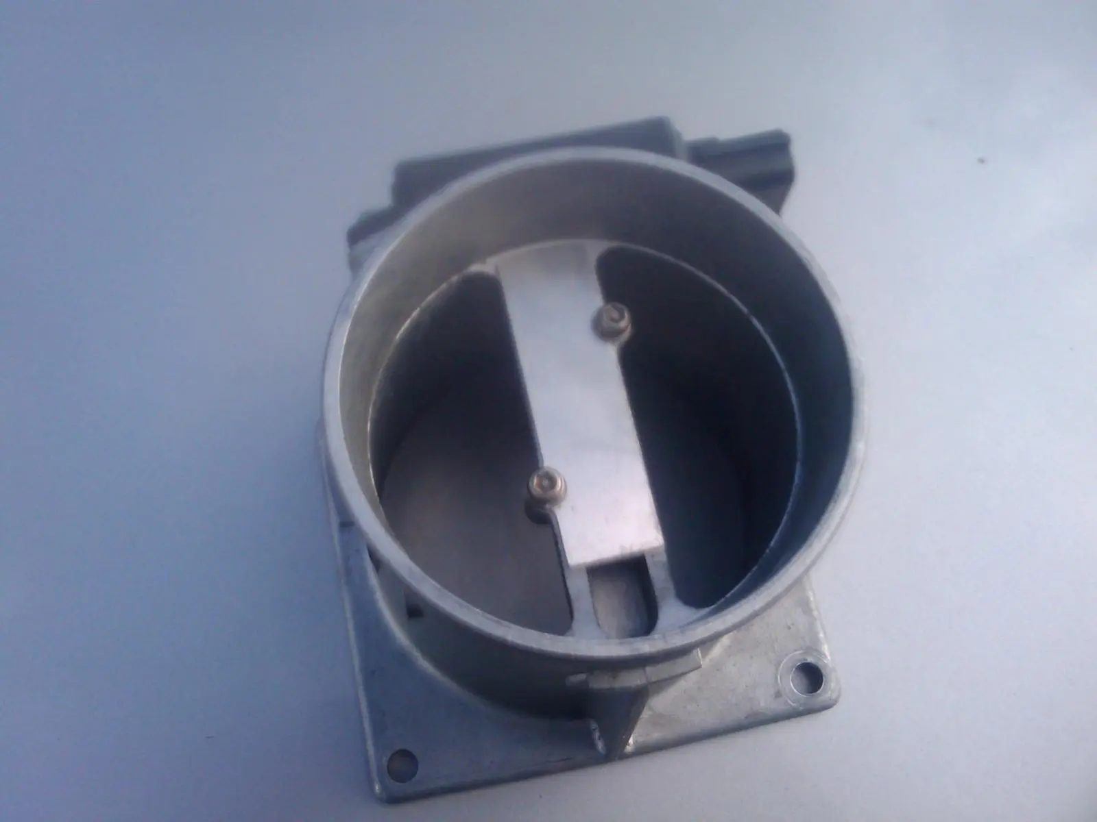

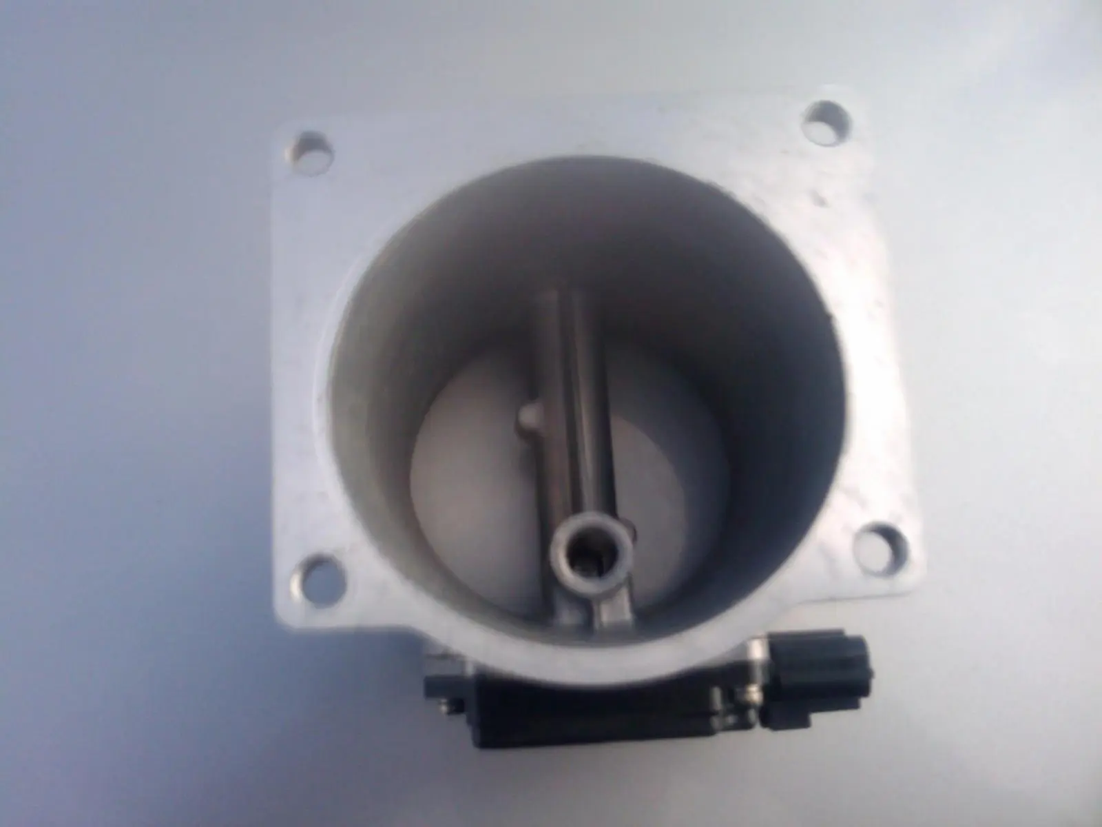

roworld Member Feb 12, 2004 105 0 17 baltimore md Sep 30, 2009 #1 Sep 30, 2009 #1 I just got a mass air off a lincoln continental, its huge has anyone used one on their foxbody. I don't know what size it is or for what size injectors. Posted via Mobile Device

vristang 15 Year Member Mar 31, 2005 4,933 101 124 Seattle Sep 30, 2009 #2 Sep 30, 2009 #2 Provide part numbers... Measure the ID, and post a pic of the housing...

roworld Member Feb 12, 2004 105 0 17 baltimore md Sep 30, 2009 #4 Sep 30, 2009 #4 front side is 3 1/4" wide and flange side is 3 1/2" wide. The p/n on the meter is f50f-12b579-aa afh80-01a Attachments big mass air.webp 28.8 KB · Views: 286 mass air.webp 23.1 KB · Views: 185
Mustang5L5 That is…until I whipped out my Bissell Mod Dude Feb 18, 2001 43,264 17,952 224 Massachusetts Sep 30, 2009 #5 Sep 30, 2009 #5 Can't use it...at least the electronics portion. I dunno about the housing with Fox electronics bolted on. The MAF's you can use are the following 1995-94 Mustang 3.8L F2VF-12B579-A2A, 1994-92 Crown Victoria 4.6L F2VF-12B579-A2A, 1995-94 Mustang, Mustang Cobra 5.0L F2VF-12B579-A2A, 1994-92 Town Car 4.6L F2VF-12B579-A2A, 1994-92 Grand Marquis 4.6L F2VF-12B579-A2A, Click to expand... http://www.stangnet.com/mustang-forums/616246-94-95-maf-install-completed-2.html

vristang 15 Year Member Mar 31, 2005 4,933 101 124 Seattle Sep 30, 2009 #6 Sep 30, 2009 #6 afh80 means 80mm housing. As already said... it isn't compatible with the stock ecu. Only way to make it work is by using a programmable chip, like Moates QuarterHorse.
