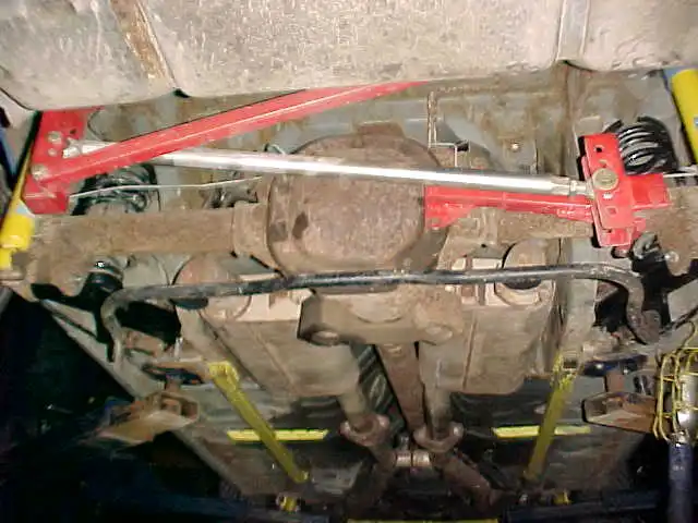

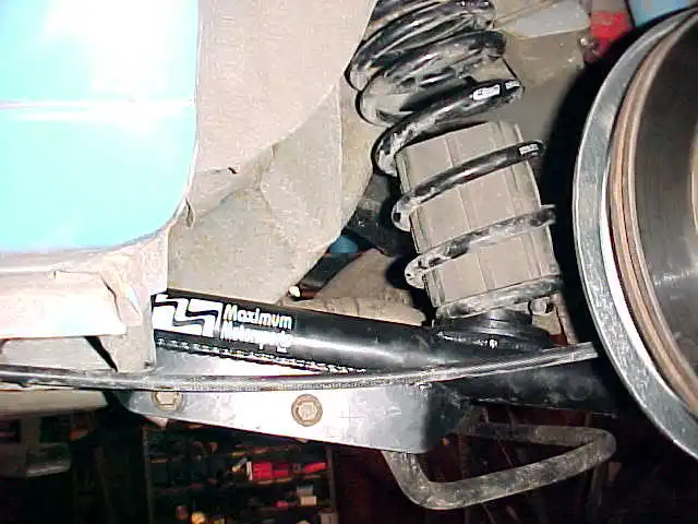

A PHB is not hard to install. I didn't have directions on how to do mine. It's a Griggs Severe Duty Adjustable PHB, and it was welden in. Took a few hours having to mock up some steel to use as reinforcement. I just got done putting in MM Control arms and they took awhile, not hard just time consuming. Here's a pic.
Here's the finished result.
And another...
