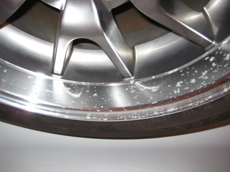

Well, long story short, I had to move for a new job in January, and the car sat outside for 2 months before I could get an underground parking. There must've been some road salt on my wheels while it sat there, and now the machined lip on both rear wheels looks like crap!
I tried mother's wheel polish and nev-r-rdull, but neither could touch it. Has anyone ever refinished wheels before? Should I totally sand-down the lip and gradually go to finer paper then polish? What would you guys do? I can't tollerate them looking like that :notnice:

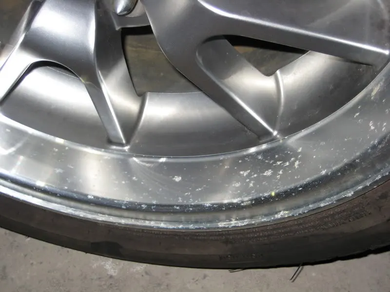

The damage:
Its even visible from far :mad:
Well, the wheels weren't super-expensive ($180 CDN each) and I got a strange feeling it will be nearly as expensive to have someone refinish them, so I might as well tackle that on my own. I don't think I can make them look even uglier.

Progress!
So I finally got to taking one wheel off and sanding it down.

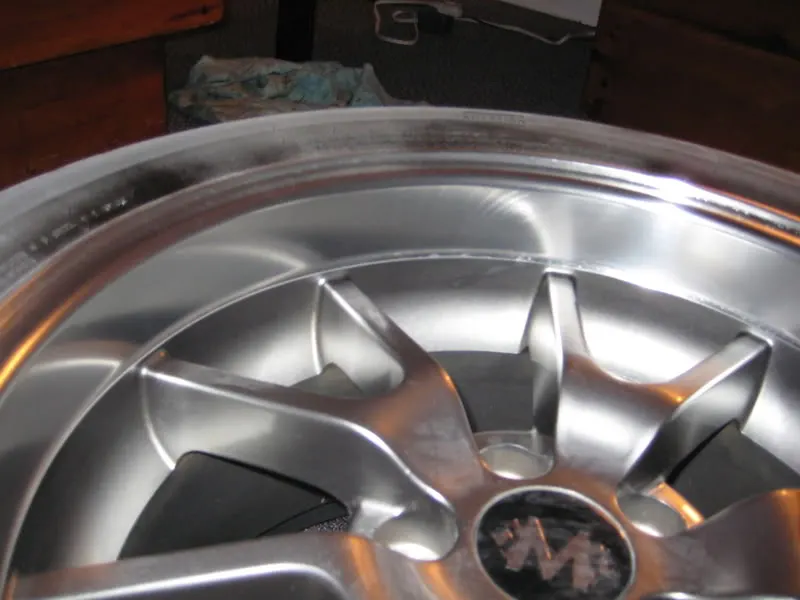

I started with 1000-grit, and quickly found I had to go down to bare metal to get rid of the spots, so I went all the way. If anyone has bought these replica DD wheels before, they'll know that you can see the machining marks on the shiny lip. Well, I sanded those down to a smooth surface, then went over everything with 2000-grit, and finally some metal polish and 3 coats of clear.
The whole process took me 2 hours and wasn't that hard, I'm glad I didn't pay someone a few hundred dollars to do it for me.

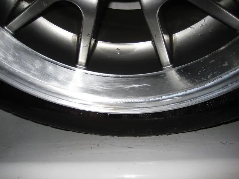

This is a reminder pic of what I started with:
This pic shows the difference the 1000-grit does, and the scratches left-behind:

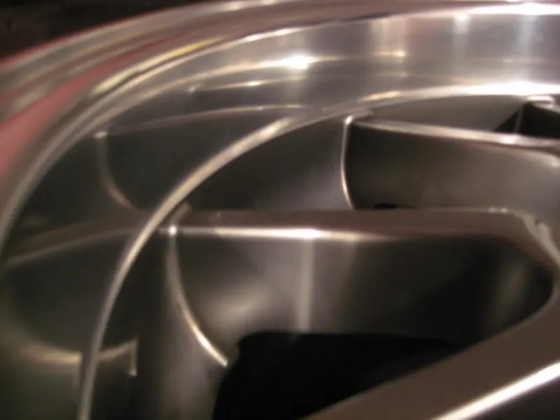

And these pics show the final product, after the clear-coat was applied:
Its not 100% perfect, there are still a few spots here and there on very edge (tire lip), but they are not that noticable. I was too lazy to take-out the dremel to fix it.
