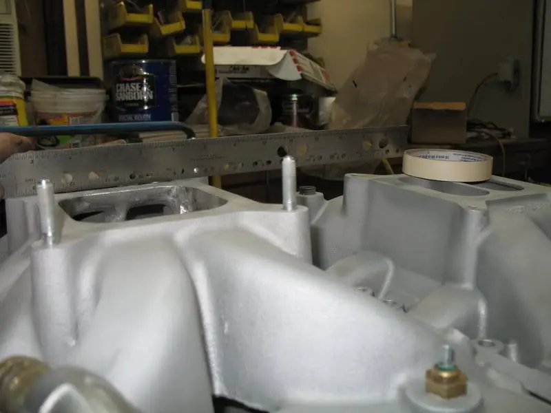

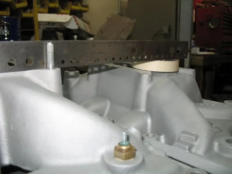

Just for the heck of it, here is a couple of pics of my modified Vic Jr and my old Stealth:
For the pics, both were being supported by the lifter valley rails and the roll of 3/4" tape is there as a visual reference.

I'm wondering how much lower the block sits in the 65/66 for you guys to "have tons of room". Maybe the K&N aircleaner and tall element is to blame entirely?
