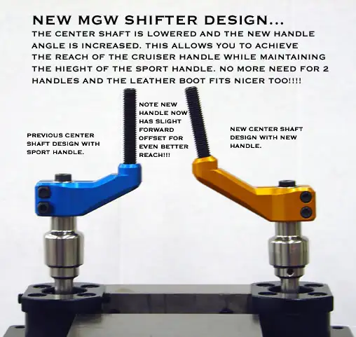

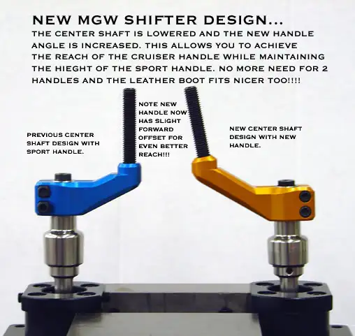

gold handle??? its not orange anymore? sheeesh :D :rlaugh: i hope they send me the orange handle.
Because im a post whore...gives you an idea of the difference between the orange/gold :rolleyes: and blue handles. unfortunately i dont think they are interchangable. if you look closely there are small differences in the new center shaft as well. either way, you have a kick ass shifter :nice:
