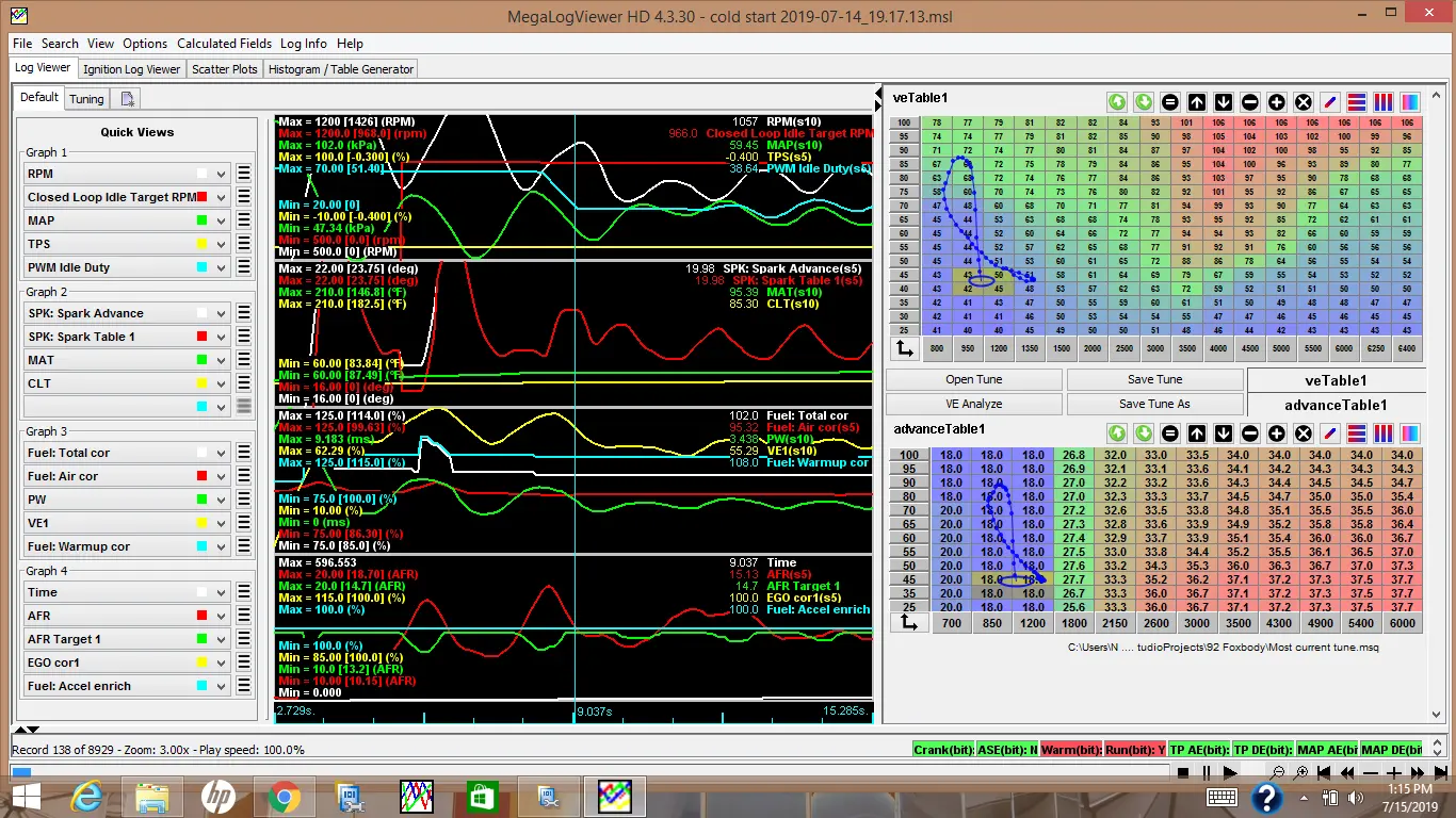

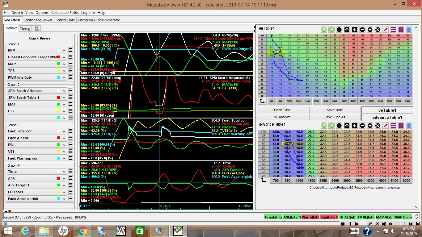

I made changes to my WUE as suggested, and reduced my lamda lag factor. I will do a cold start when i get home and report back. Also with the timing, i attached screenshots of the parts that confused me. The first pic is where the timing dropped to 16.69 right before ASE kicked in again. The second screen shot is where my timing is at 19.98 at 1057 rpm. Neither event seems to match what my ignition table is calling for. Am I looking at this wrong or missing something?

Remove the smoothing on spark. [S5] is significant smoothing... I only smooth rpm and map sometimes afr if I am just doing a casual review. For picking out issues you want very little to no smoothing.
Thanks for that Tip! Once i changed that, what i was viewing made much more sense. I didn't realized how much smoothing affected accuracy. I've only been able to start it once since your suggestions. It defiantly improved. Now that i'm reading the log viewer properly, i should be able to work things out from here.
